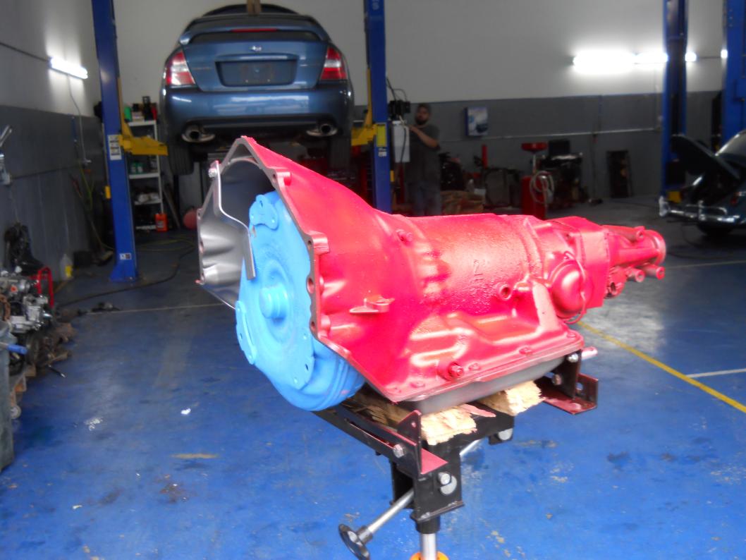

got the tranny today ,painted it myself ,the tranny guy said there not that easy to find around hear ,for a rebuilt ,it has b&m stage 2 shift kit upgraded the torque coverter to some stall new clutches an the kick down cable kit . not sure exactly what they did ,though its ready to handle 500hp+ an for 1000.00 rebuilt not remanufactured ,I can have it remanufactured for 1500.00 seem pretty good ,the spacer they put there seen its what will make it work an the 700r4 tail shaft was the same as my old one ,an like yousaid the old one was not going to last long ,thanks guys post more pics soon
