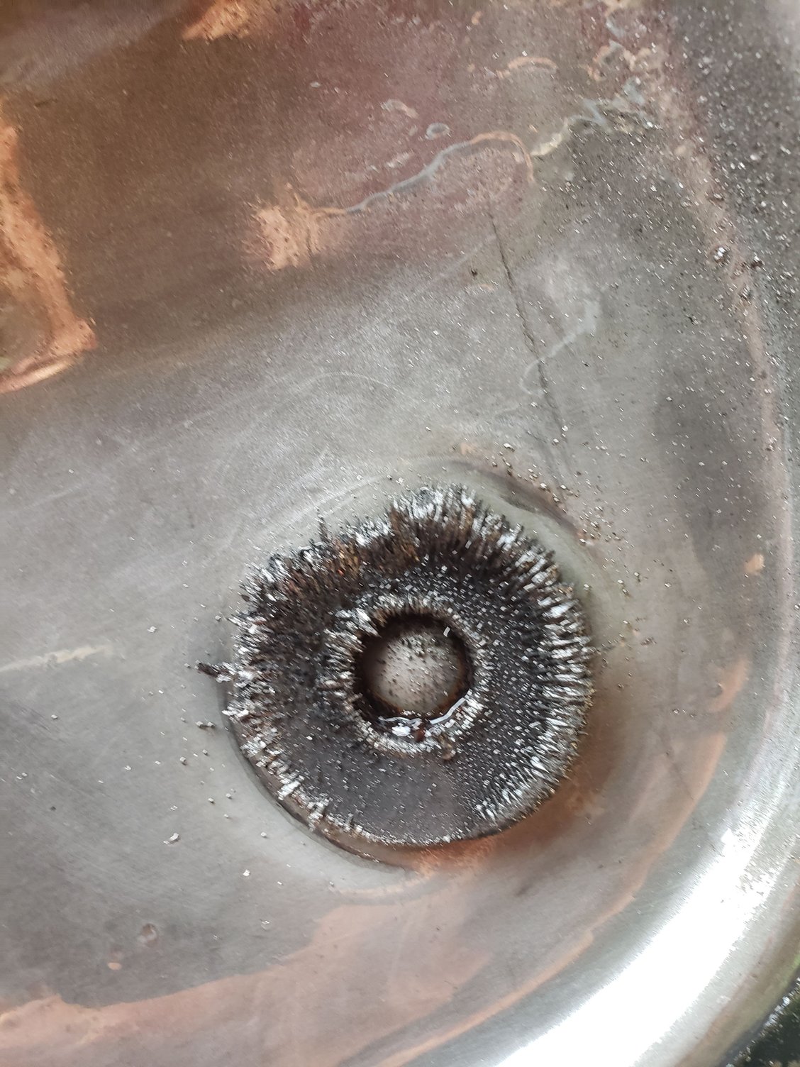

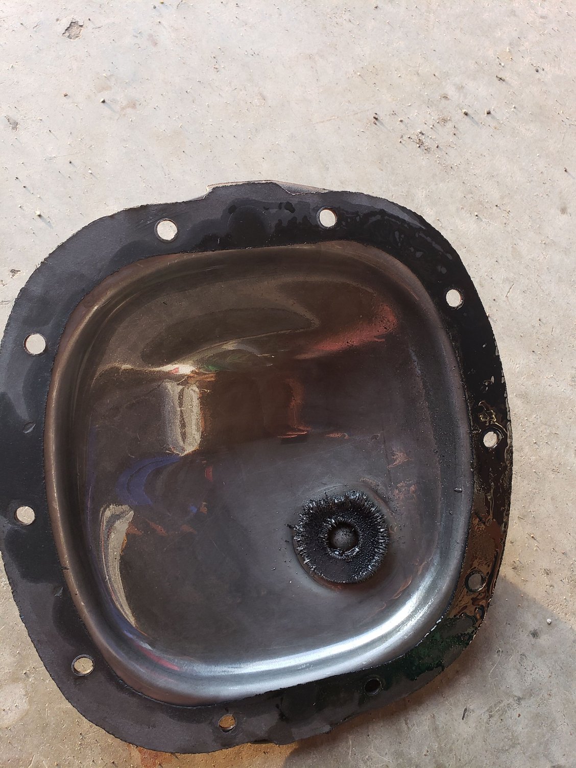

The pinion gear is in way too deep and digging into the ring gear carrier. The pinion gear must have slipped in when you had it apart, and the inner bearing wasn't seated back in place when you reassembled. And, the ring gear teeth are getting shaved down like a knife edge. It's toast.

See in the pictures? The line going across the carrier? Is that the carrier broken in half? Or is that line suppose to be there? I dont remember when I took the cover off to change the seal if it supposed to be like that. Also, the pinion nut didnt have any threads exposed past the nut meaning it is almost at its maximum looseness. And I talked to my mechanic and told him the tightness I put it, and he said that should be way too loose, he said it always zips it on with impact gun till it stops and never bad a problem. So I dont know I'm being told like 4 different torques. Time to take it to a shop...
