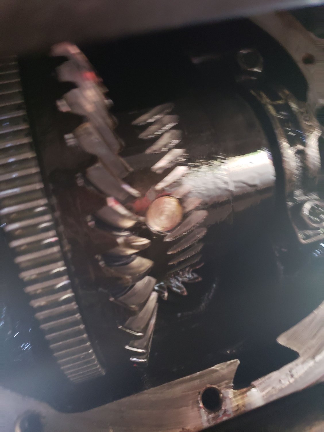

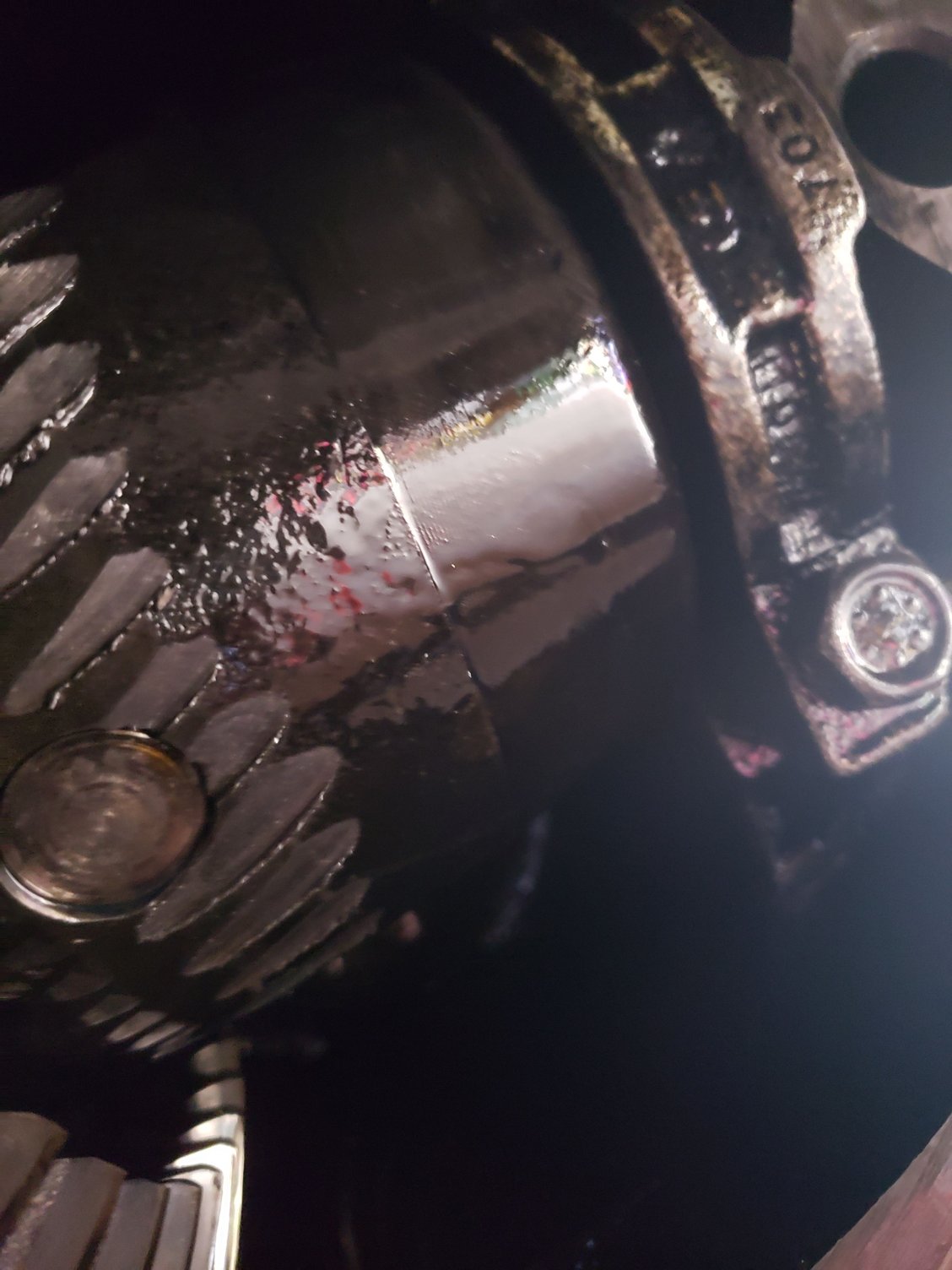

UPDATE: Just finished doing multiple tests as you guys suggested, I tried moving the driveshaft for play up and down and in and out and nothing, then proceded to take the driveshaft off and the yoke had play in it and it was leaking again from the seal i just replaced, assuming the leak is caused from the play in the yoke, then took the front cover off and then quickly found my problem...as you can see in the pictures. The magnet was clean yesterday as i took it off to clean the magnet ans change the fluid and replace the gasket.
