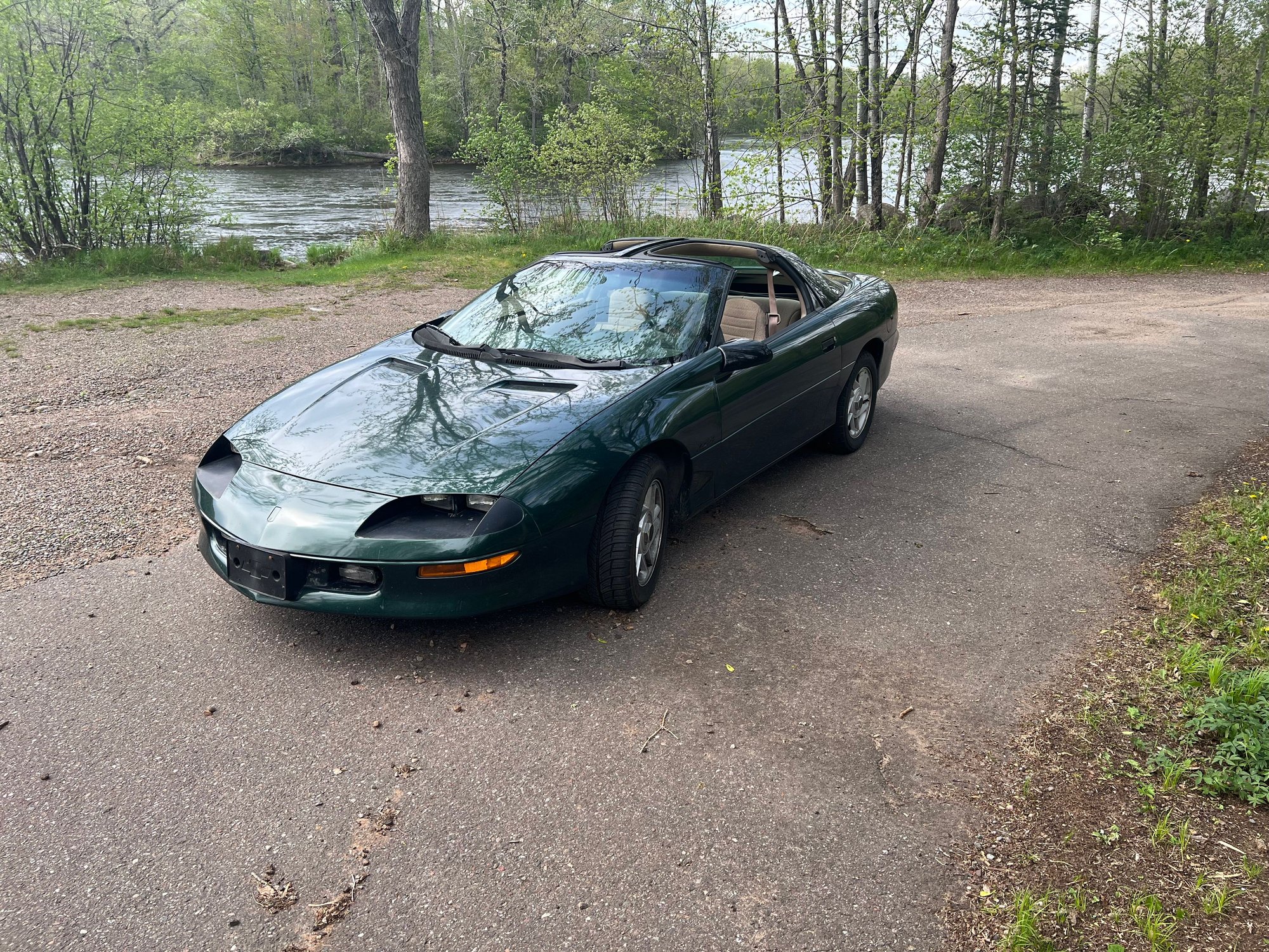

Default Update: Bought a Z28
Just wanted to update everyone, my 3.4 sat dead for a year and a half and I decided it wasn’t worth fixing, so about a month ago I picked up this 95 Z28. It came with long tube headers and a Flowmaster exhaust, 100k miles and never seen winter. I’m very happy I decided to wait for a decent deal ($5k)
Old Jun 15, 2025 | 10:20 PM
Posts: 22,017
wow is that paint as good as it looks?
Old Jun 20, 2025 | 07:29 PM
ClappedOut4th's Avatar
Joined: Oct 2020
Posts: 7
Almost 😅 there’s some real hard dry sap spots I can’t really get off, plus I just had a bubble of I believe clearcoat on the top of the sail panel that came off in a big flake. Other than that it’s pretty clean though
