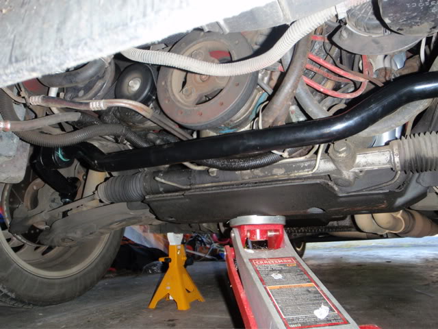

i think you will be impressed with the hollow set
front is hollow

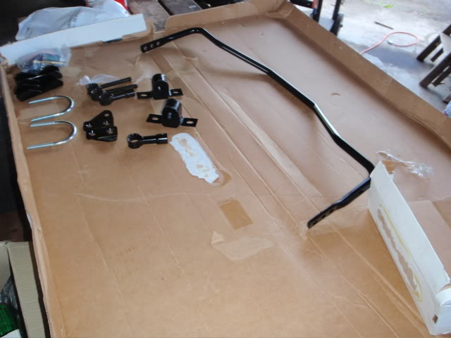

rear i got is adjustable

Those pictures are of the 35mm hollow front and 22mm hollow adjustable rear from straino correct? And I'll most likely do the rear suspension with panhard rod, LCAs, and sway bar after the shocks/springs

Posts: 22,042
yes. here is a link to my build thread. this page has the sway bars in it https://camaroforums.com/forum/93-02...s-42437/page7/
