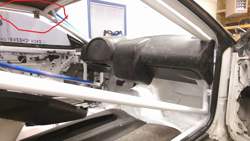

looks like she has just a bar which shouldn't be anywhere near her head.
when you bring the halo bar in for a 10pt+, thats when it gets dangerous, picture of mine for reference.

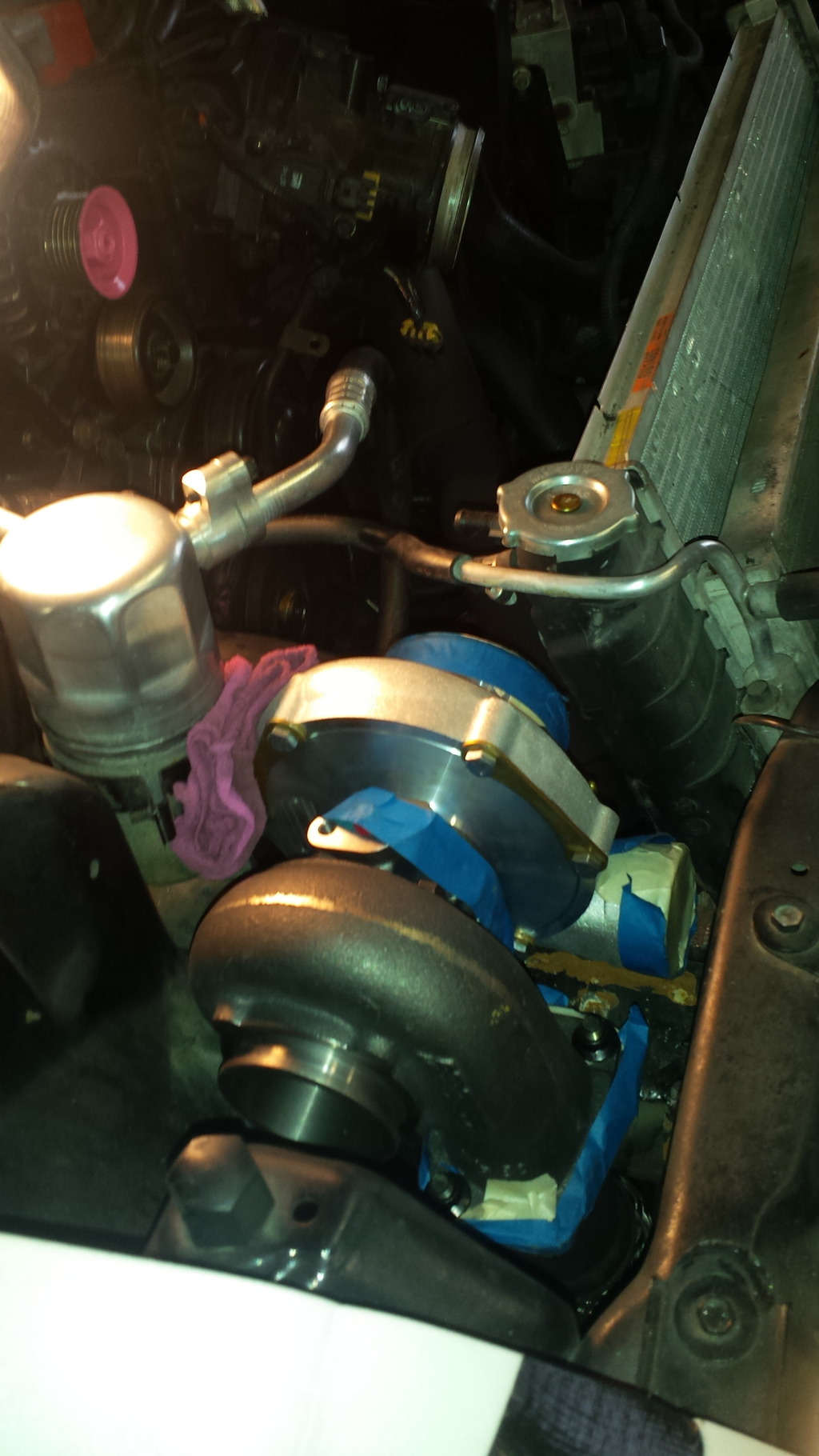

Turbo is mocked up

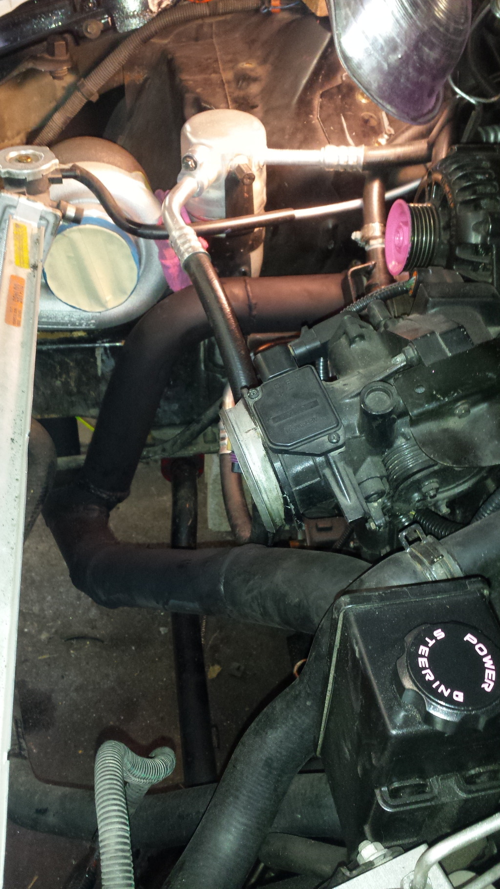

Finally got the rest of these mocked up.

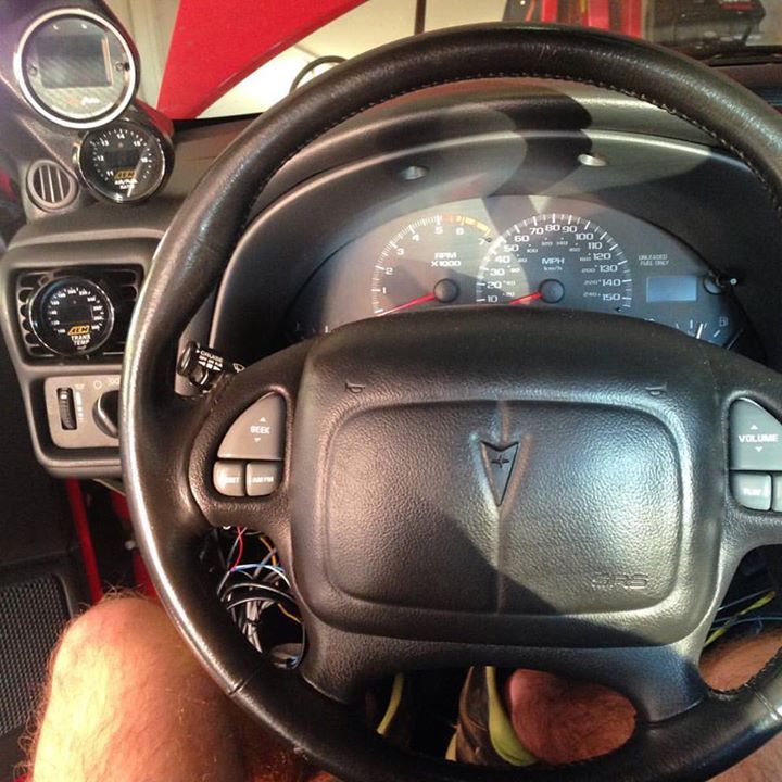

I would junk the volts gauge and get yourself a nice wideband like an AEM failsafe, maybe a failsafe for the boost gauge as well. It could save you if your engine leans out or overboosts. I would also suggest a trans temp gauge if you are an auto.
This is my setup: Aeroforce Interceptor on top, wideband below, and then trans temp in the vent.
