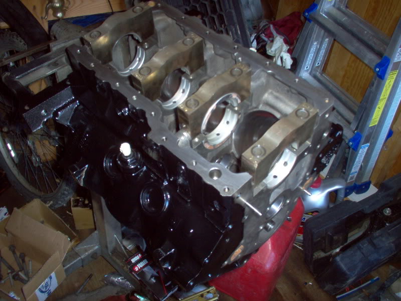

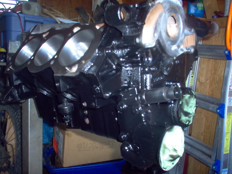

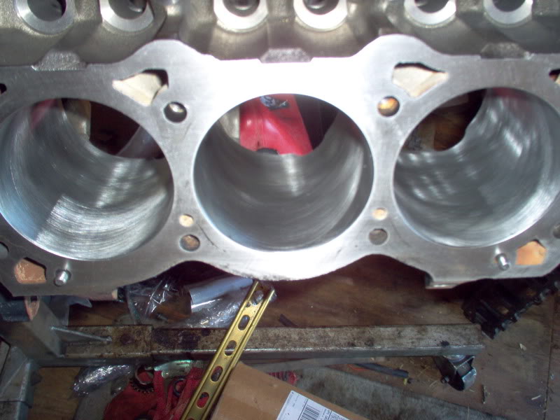

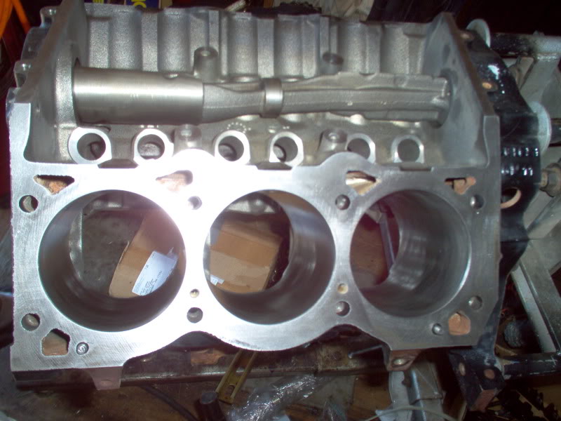

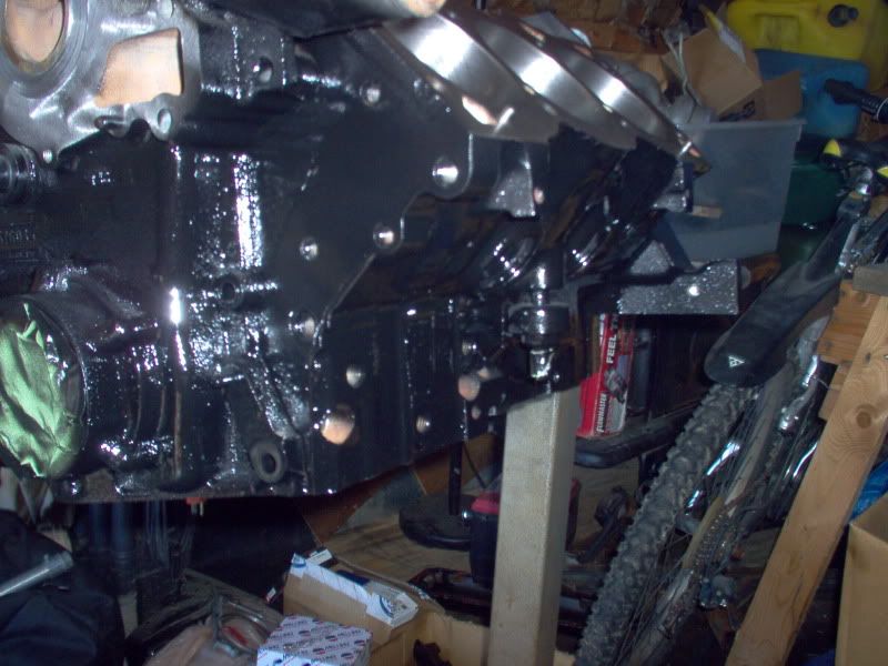

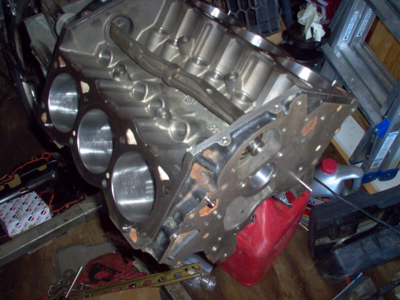

Block pics taken by Case for me

looks good when you gonna start putting it together

I think he might have done some today, but I'm going over Tuesday with some parts that he needs that I still have and I'm going to help (if I can) to assemble more of it.
