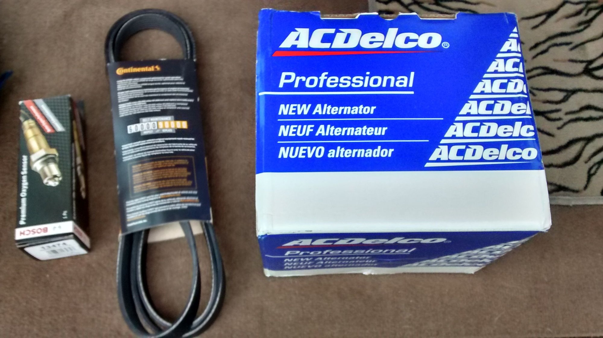

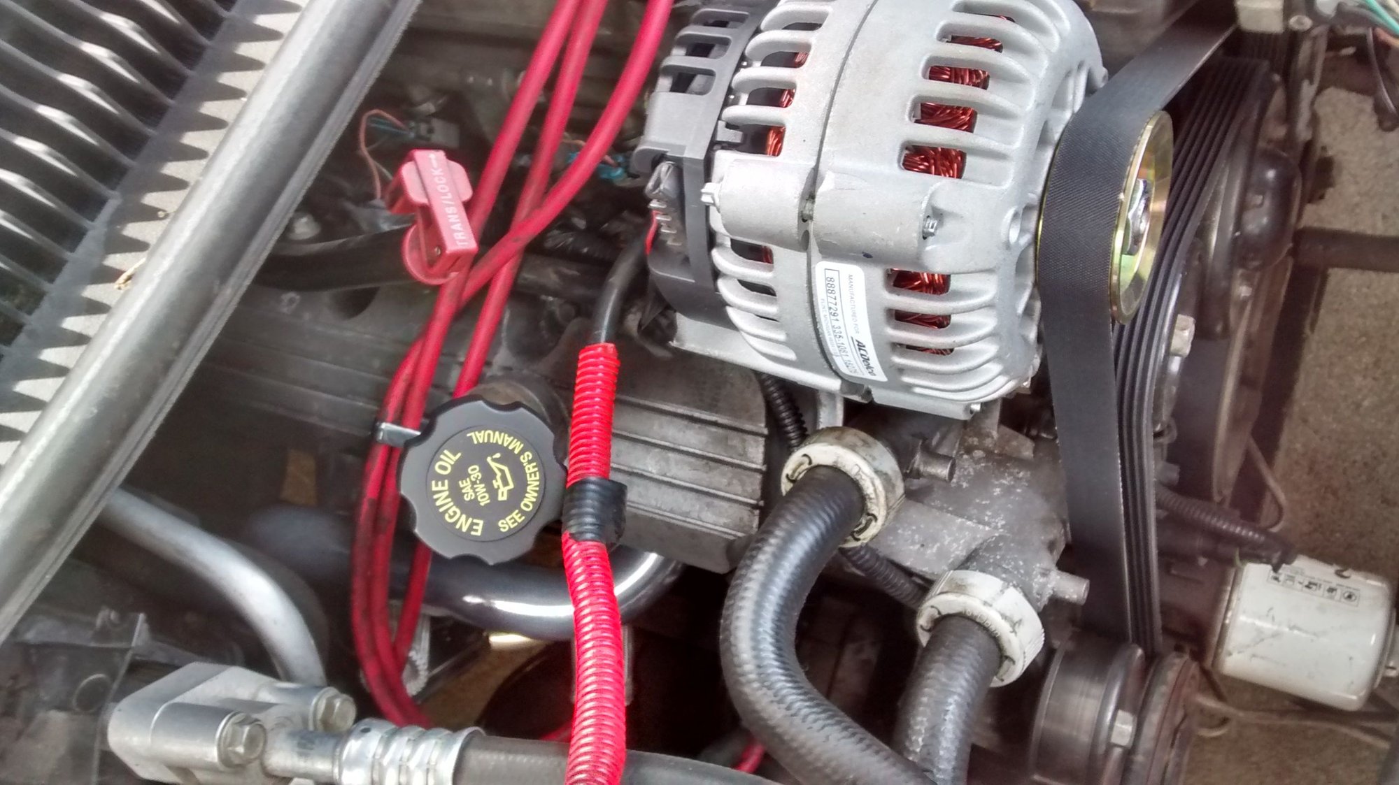

I've added a new alternator to the list. Since I'm replacing that I'm replacing the serpentine belt with it as well. Should be here Friday, the original one appears to have given out on Saturday.

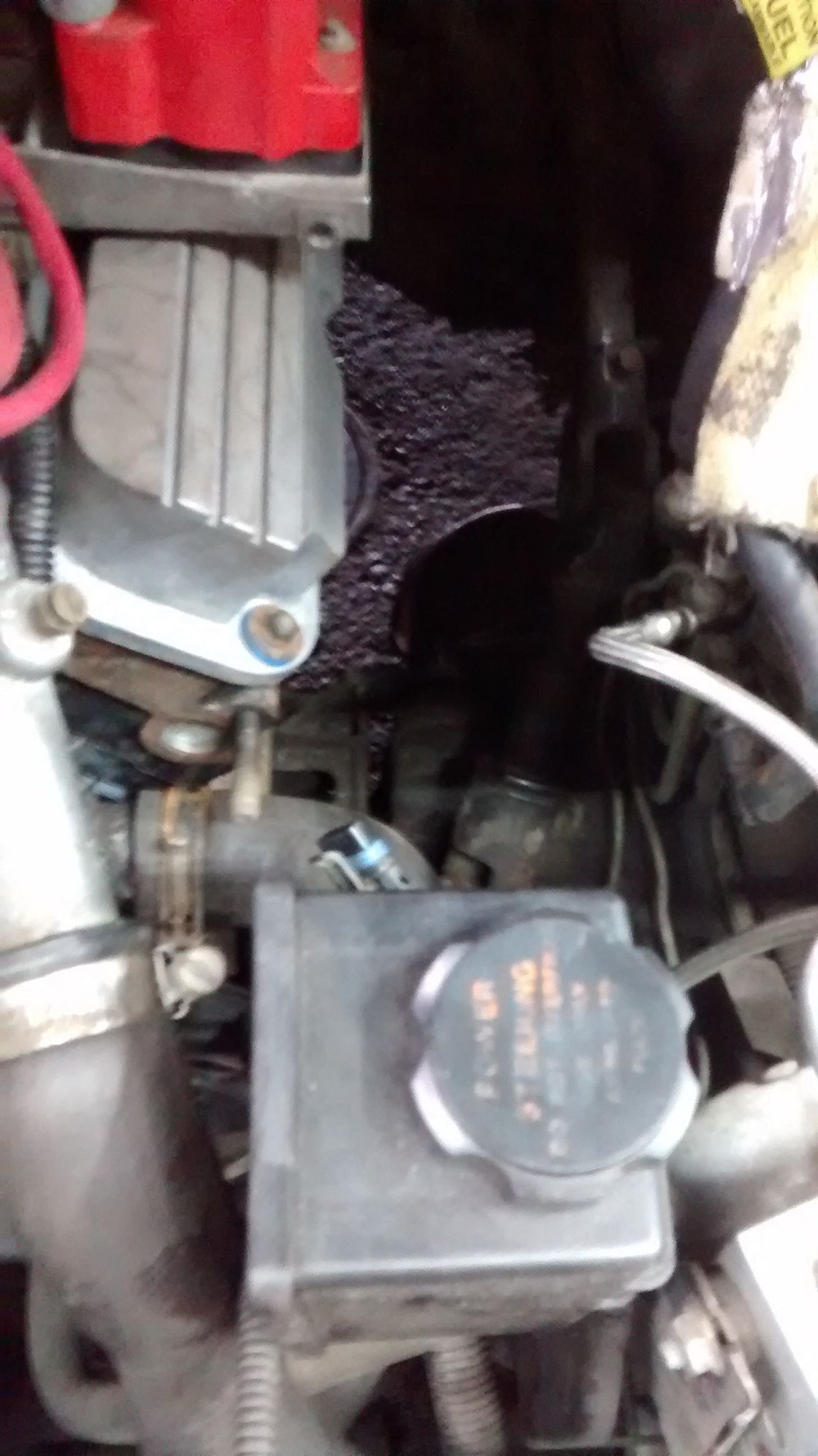

New Belt, O2 & Alternator
Green backlighting, like it should be
Missing manifold
New Pacesetter Header

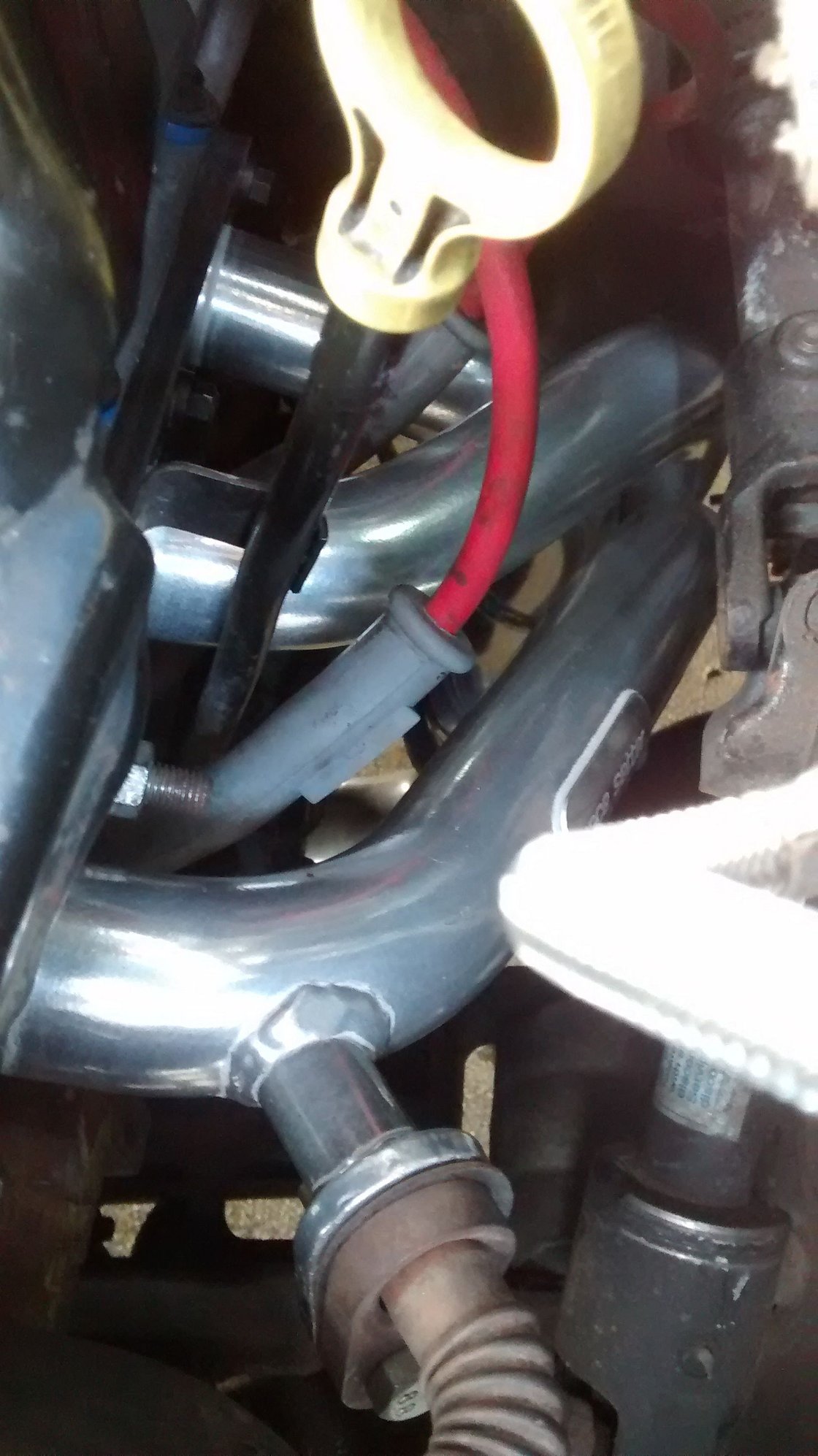

The new headers are in, and they definitely changed the tone of the exhaust, without question they make a much deeper sound-plus it eliminated the exhaust chatter I couldn't get rid of with the stock manifolds. Had to bend the straight boots on the MSD wires a bit to get them off the headers on the passenger side. Thinking about perhaps getting a Taylor set that has a build your wire option for 8mm plug wires so that I can angle the wires away from the headers properly. Also saw that MSD has a single performance 8.5mm plug wire that might work, but not sure if it's long enough since it has to reach across the engine from the coil packs. The one O2 sensor that I had never had out during my ownership of the car took most of the threading with it from the old manifold, so I ended up picking up a Bosch replacement for that as well. Other than that the Pacesetter kit had everything that I needed to get the headers in, and it joined up reasonably well for me (I was a little concerned about this since the exhaust was modified by the PO, but it worked out with very little in the way of problems).

Default Couple more Header pictures
Driver side header
Boot protectors
passenger side header
Yeah, I was looking at the tune chips from the performance shop I got the rocker arms from, fairly reasonable price wise. I am thinking about it but do need to put a little focus on the Discovery II for a bit. Right now the only thing I've got slated for the Camaro is to replace the other 3 tires after putting a single Cooper on. This weekend should be a good shakedown test since I've got a 600 mile round trip coming up.
Reaching around the headers is a little challenging to get the wires set up, but the bent boots seem to be working fine.
Added a couple of boot protectors to the plug wires on the passenger side since they were sitting a little close to the headers. Put in a couple of wire separators for the plug wires, and then went to work on the truck instead yesterday (air intake hose replacement). Bumper should show up today.
