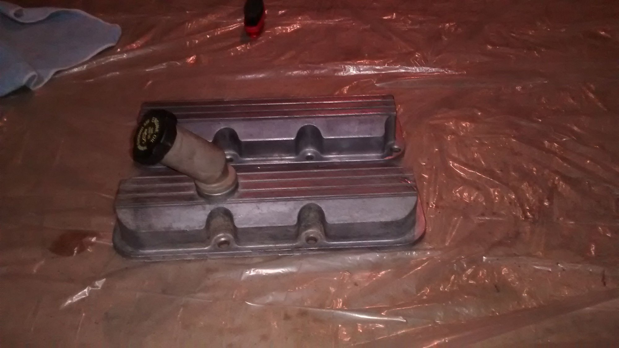

Since that happened, probably won't paint the headers, but I do have the heat shields and valve covers, we'll see if I can polish those tonight while I wait on the heads and rockers tomorrow. I see nobody sells those heat shields anymore, so despite the fact the ones I have are a little bit mangled, I'll be putting them back on. I've got the rest of the gaskets, head gaskets and the exhaust manifold gaskets arrived this morning. Also have a couple of metal cooling elbows that I don't think I mentioned earlier to replace the weaker plastic ones. Now, if I can just get my wife to come back from shopping to watch the boy, I can get back in the garage. Still hopeful I can get this back together in time for a long trip this weekend, including break in time.

Valve covers, rear polished
cleaned up the heat shields

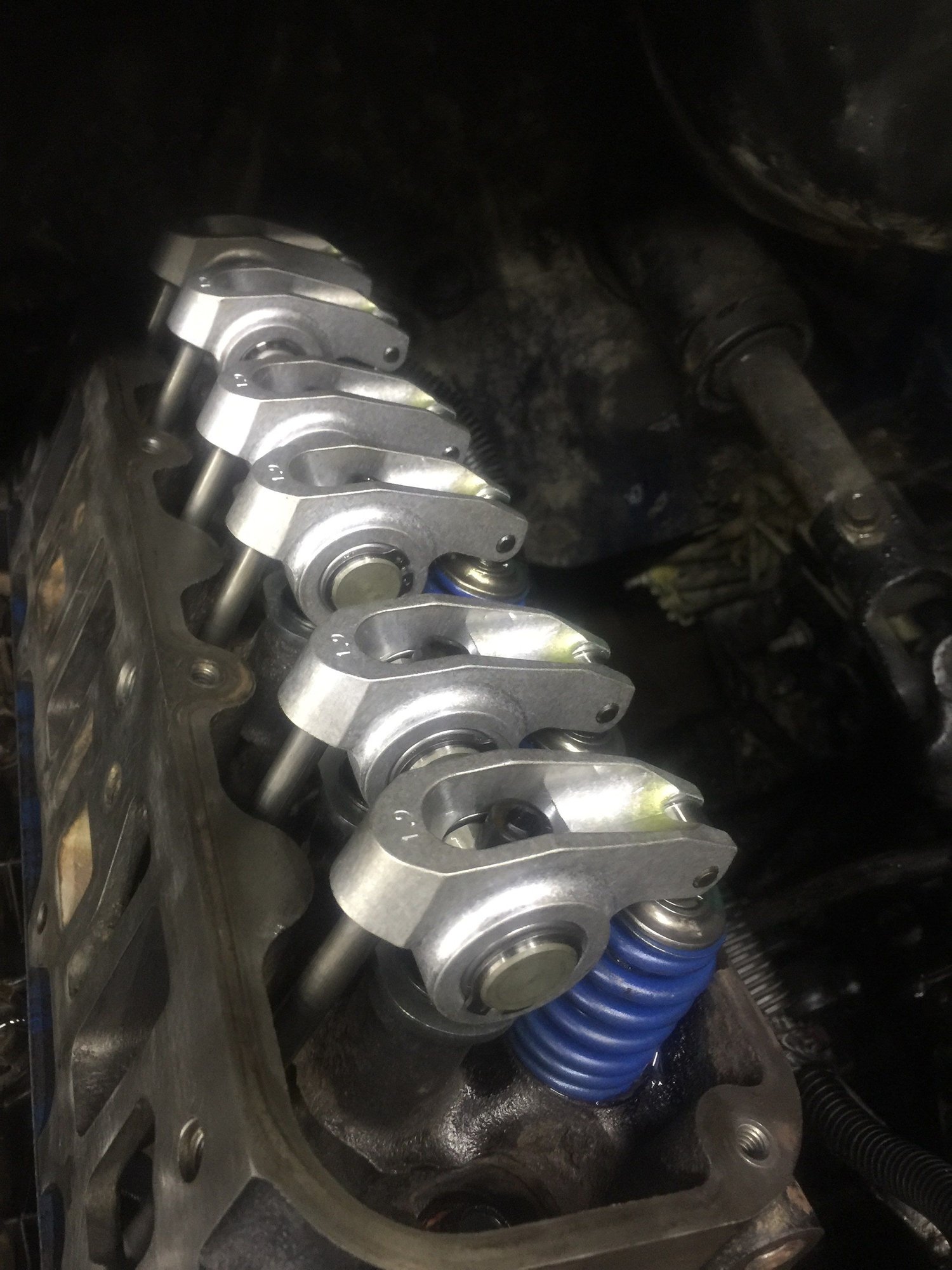

Yella Terras, LS6 valve springs, Viton valve seals

Pictures of the valve covers and heat shields. The front valve cover is cleaned but not polished, the back one is polished. I couldn't get them looking like billet chrome, but they do look better than they did when they came out.
The Yella Terras and associated parts arrived. According to Intense Performance these are supposed to add 20-24 HP with the upgraded valve springs. BTW, Intense was exceptionally pleasant to work with getting these parts!
