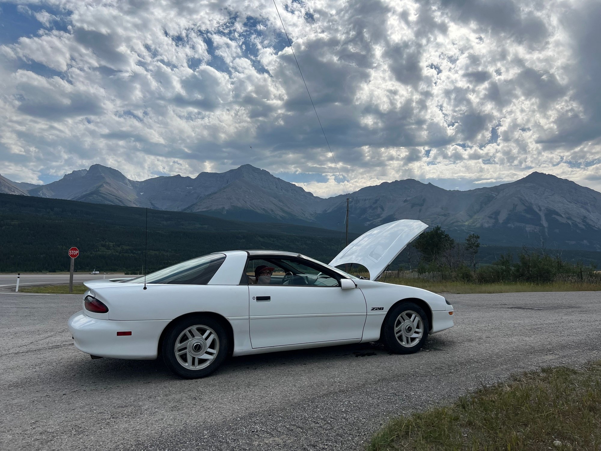

I got a 95 z28 Camaro on trade with 189xxx km. Had lots of work done to it but runs weird.
Has a weird misfire on idle until to warm temp.

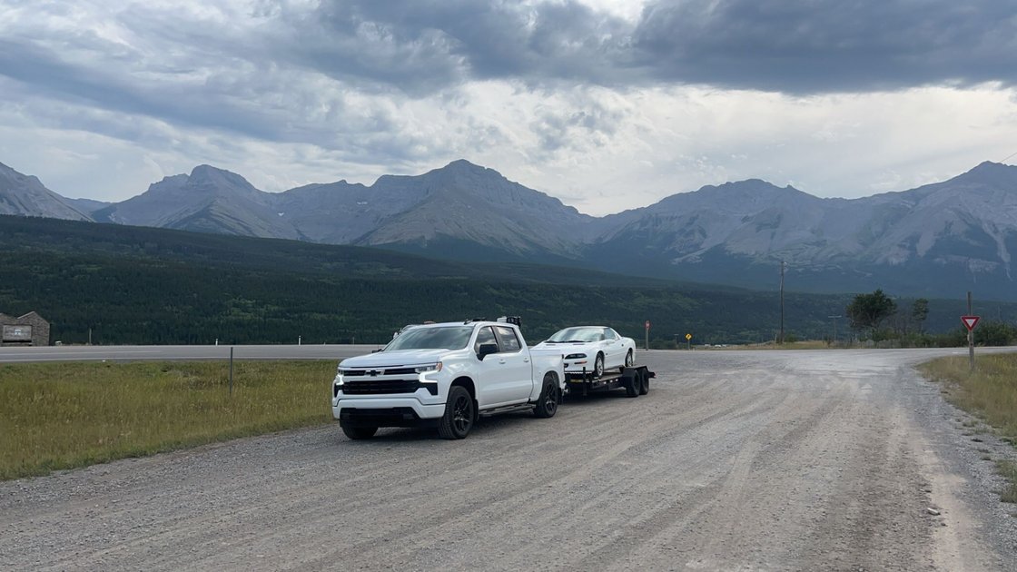

Then also the other day I was driving it and blew a rad hose off. Pulled over and got my truck and trailer brought it home. I reattached the hose and filled it with coolant/water to see if it would work again. Over heated. Pulled the thermostat out and boiled it. It opened and threw it back in.
I have issues not being able to read the ob1 as it has a ob2 connector as I’m sure you’re all aware, I don’t have a laptop so I can’t use that program.
kinda stuck with what to do, I believe it’ll need a complete engine refresh as the oil pressure is low when idling.
I also replaced the wheel bearings as it was making a sound when I turned the wheels. It still makes the noise, this car is driving me insane. I want to love it so bad but seems to be riddled with issues, I’m not into it for very much.
Ls swaps seem like a major pain due to the ob1 and lt1 engine in there.
Any ideas why it’s still overheating? I checked the oil it’s clean, no white smoke etc. it was driving ok prior once warmed up, put roughly 1000km on it but now the heat seems to be an issue so I’m thinking possible head gasket? I tried to bleed the coolant system with the screw on the hose etc.
