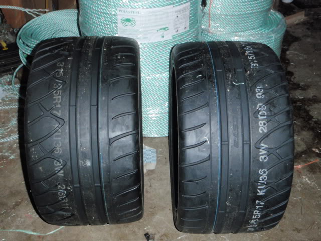

got the 315's, waiting on the wheels so i can check fitting.

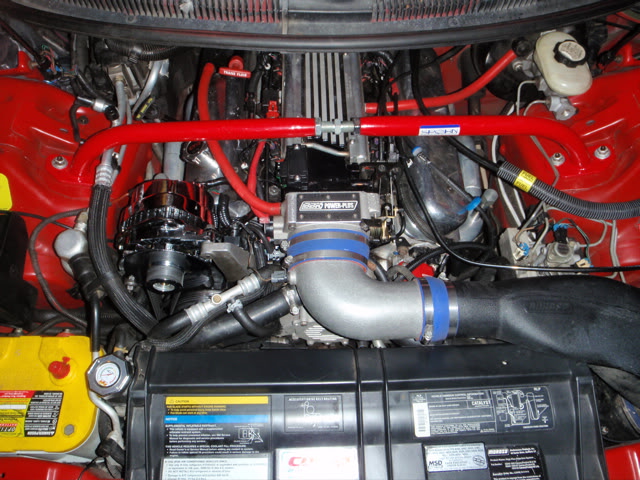

installed a new powermaster 200 amp alternator. lower rear bracket from exhaust manifold is to long for this one. must be a shorter one for the newer lt cars.

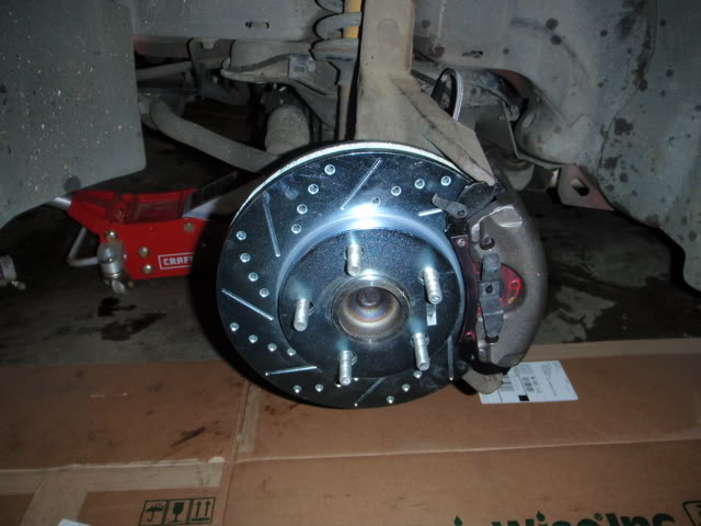

Old Jan 26, 2011 | 01:13 AM
  #116
Posts: 22,027
got time to install hubs, power stop rotors, bendix calipers, hawk ceramic pads and strano stainless brake lines.

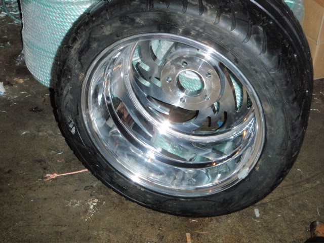

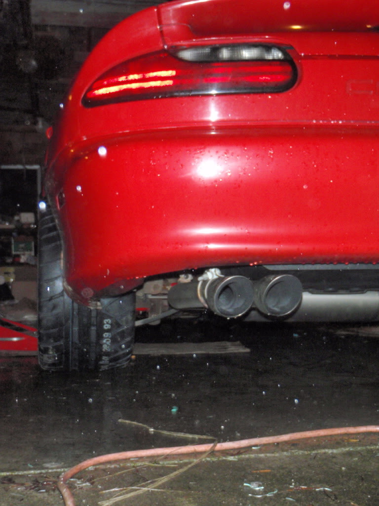

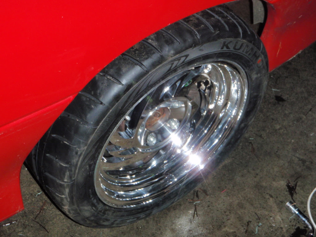

Old Jan 26, 2011 | 08:53 AM
  #117
Posts: 22,027

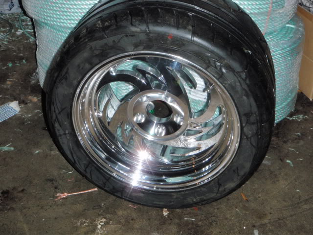

got wheels and had em mounted. then test fit. i have rolled the fender edge's on both sides and, yah liberty, got the hammer out and made some slite mods to the inner fenderwell. still need to center the rearend better. wheels, 11x17, tires 315x35

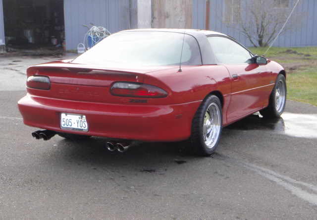

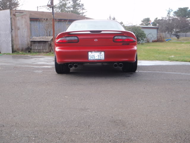

Old Jan 26, 2011 | 05:17 PM
  #118
Posts: 22,027
got wheels on and washed er up. need to go to the beach and take some pictures.
