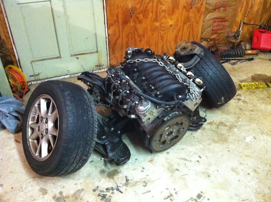

Some of you might know me from the second gen section with my 74 Z28 Type LT. I recently bought a 2001 Z28 with a seized engine for super cheap. Sourced a local LQ4 shortblock, LS6 243 GTO heads, using the LS6 intake off the current car. Went through the assembly and checked it out and it looks good. I was told the engine had around 30k on it when removed and it looked nice and clean with inspection and tear down. Reassembled with Cometic gaskets to give me a decent quench and put me around 10.25:1 SCR.
Day I brought it home:
Engine coming out:
Transmission out:
Shortblock teardown and inspection. Checking for piston height to setup quench and gasket selection.
LQ4 on the stand, LS1 in the foreground waiting to be tore down and see what seized the engine (more on that in a moment).
K member rolled out from under the car
Heads going on the LQ4 block with ARP head bolts.
Engine assembled and back on the k member
The reason the LS1 was seized:
Apparently the LS1 overheated a number of times (oil baked to anything and everything) and weakened the connecting rods. One bent and bound itself against a blade on the crankshaft. No damage to the engine or crankshaft upon visual inspection. So I will probably rebuild and sell the LS1 or throw it in my 74 Camaro since I already have an LS1 T56 transmission in it.
I hope to mate up the transmission and engine tonight and roll it under the car. Hopefully have it up and running in the next couple of days or during the weekend.

I got the transmission hooked up to the engine and rolled the k member back and up under the car. Hooked up the transmission lines and ran them. Put the shocks back into their position and ready to lower the car over the engine and transmission. I still need to put the exhaust manifolds on and the spark plugs in and I should be ready. Trying to think of everything that really needs to be done before I lower the car back into place.

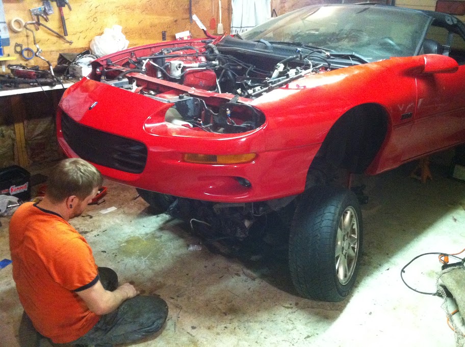

Some progress pics, nothing major. That's me in the pics.
Engine back on k-member.
Looking at the progress right before attaching the transmission.
Transmission hooked up with transmission cooler lines routed and plugged into the side of the transmission.
Hopefully will be wrapping everything up this weekend. I have a 3 day weekend this weekend and will hopefully be putting it to good use. I hope to also be going on a roadtrip this weekend and picking up a bolt on cowled hood for it also.
