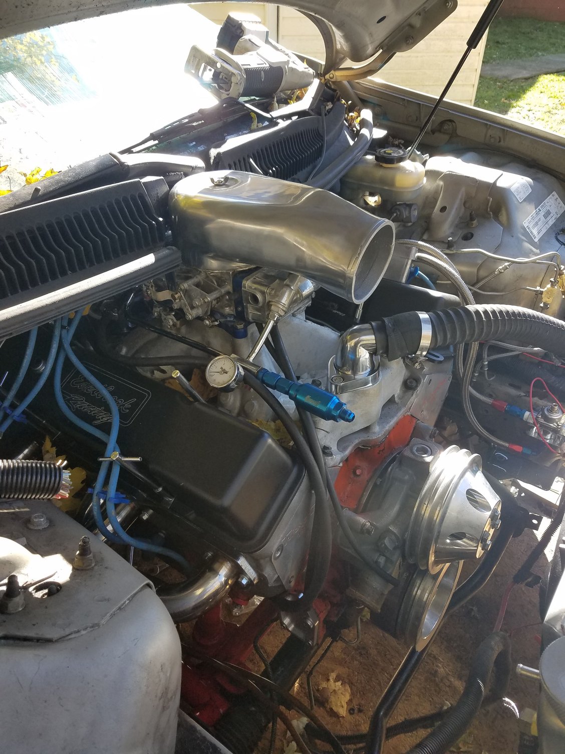

Old Oct 28, 2017 | 09:32 PM
00camarosbc's Avatar
Joined: Oct 2017
Posts: 6
Old Oct 28, 2017 | 09:48 PM
Joined: Oct 2017
Posts: 6
I bought bmr's front tubular k member and their transmission crossmember with torque arm relocation bracket for my turbo 400... and speed engineering lt1 headers fit perfectly... no rubbing or hitting anywhere... I've put alot of thought and effort into this build I just assumed I could use the key to start the car but if I can't it's no big deal... this engine and trans was in my 1973 gremlin but due to not being able to find a hood, door handles etc I pulled it out and put it in my camaro (the v6 blew up)... the engine is a 383 stroker, four bolt main with forged internals.. competition ported trick flow 195 heads, 2.02 / 1.60 titanium valves, 64cc chambers with trick flows track max roller cam and springs kit.. cam is a .558 lift on both intake and exhaust with 232/246 duration on a 112 lsa...trick flow roller rockers, super vic Jr Intake that's been port matched to the heads and a Holley 750 double pumper with mech secondaries.. 11.5 to 1 compression... according to trick flow, with my cubic inch and the parts I've used it should be making over 700 hp... I know super chevy magazine built a 355 with the same heads( except theirs were as cast not ported) and the same cam, a 750 Carter and a dual plane and it made over 540 hp at the flywheel... I also know I raced a pullied and tuned 2013 Shelby gt 500 in the gremlin and gapped his behind baaaddddd ... and mind u i was using the stock amc 20 rear end with open diff and 3.08 gears. Haha.
