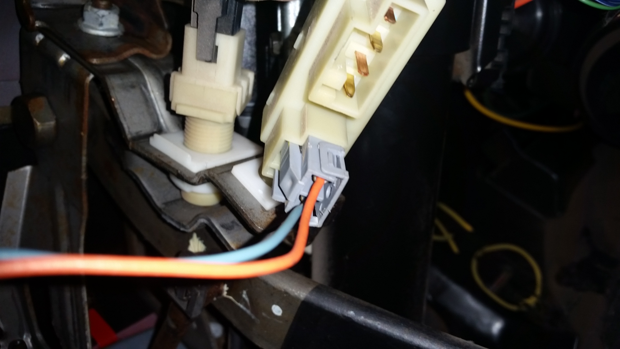

Old Apr 16, 2016 | 01:26 PM
Winder's Avatar
Joined: Oct 2015
Posts: 61
From: WNY
Okay. I narrowed it down to the blue connector thats on my main break switch. I dont know what the small one does but its not the problem. The brake light connector is fine but what ever the blue one is thats whats causing my problems. I drove the car around with the blue one unplugged and it seemed fine, no dash lights other than my abs light. But thats always been on.
Attached Thumbnails Strange wiring-20160416_142053%5B1%5D.jpg   Strange wiring-20160416_142035%5B1%5D.jpg
