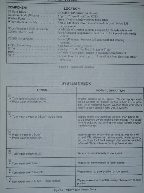

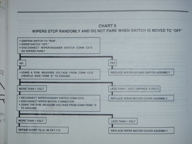

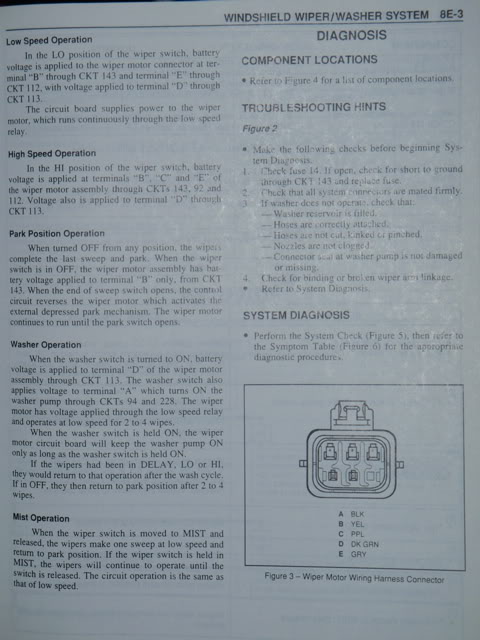

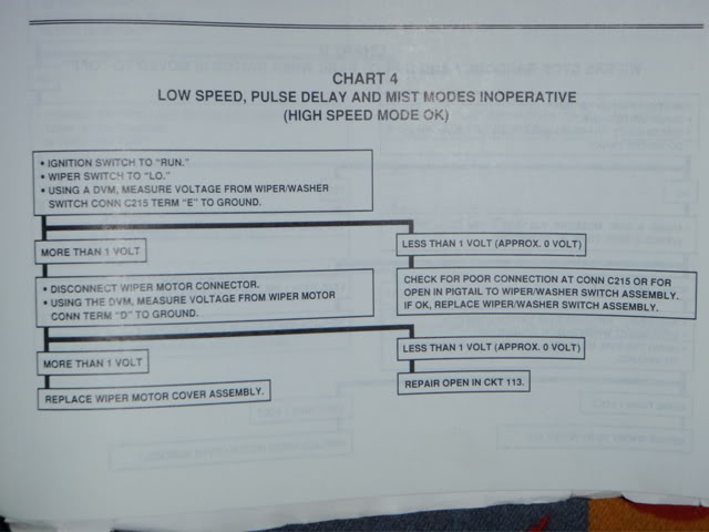

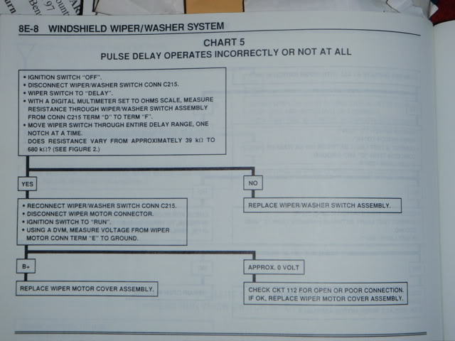

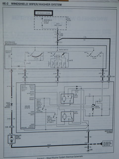

i dont think so. see if any of this will help.

Ok heres the soultion:
I got them to work. I found a loose connection deep inside my dashboard but there is still a problem: it still only works on 3 settings? any suggestions about that?

what three settings?

The highest setting, the lowest setting and one random one in between
Old Sep 26, 2010 | 03:43 PM
  #16
Posts: 22,027
are we talking about the delay settings or the on settings?

the on setting "High" works. 2 delay settings work: the longest delay and a random one in the middle
Old Sep 29, 2010 | 12:39 AM
  #18
Posts: 22,027
im gona say theres still a bad connection somewhere.
