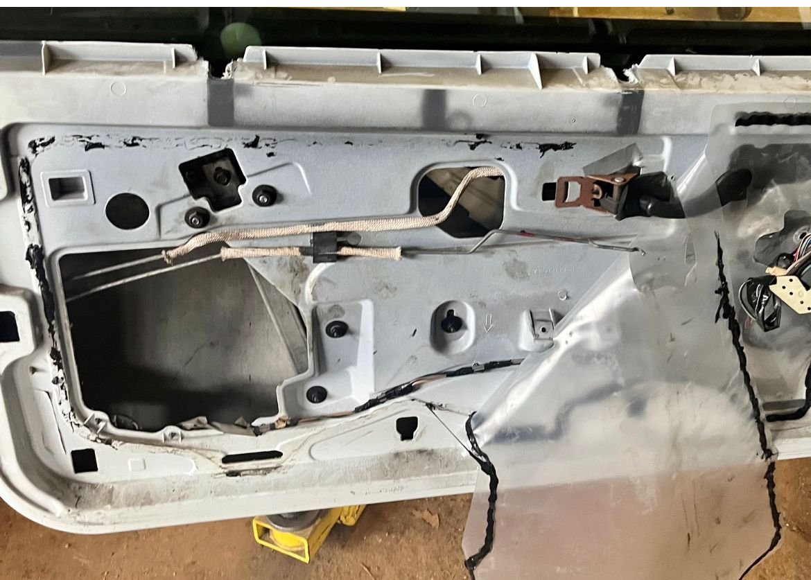

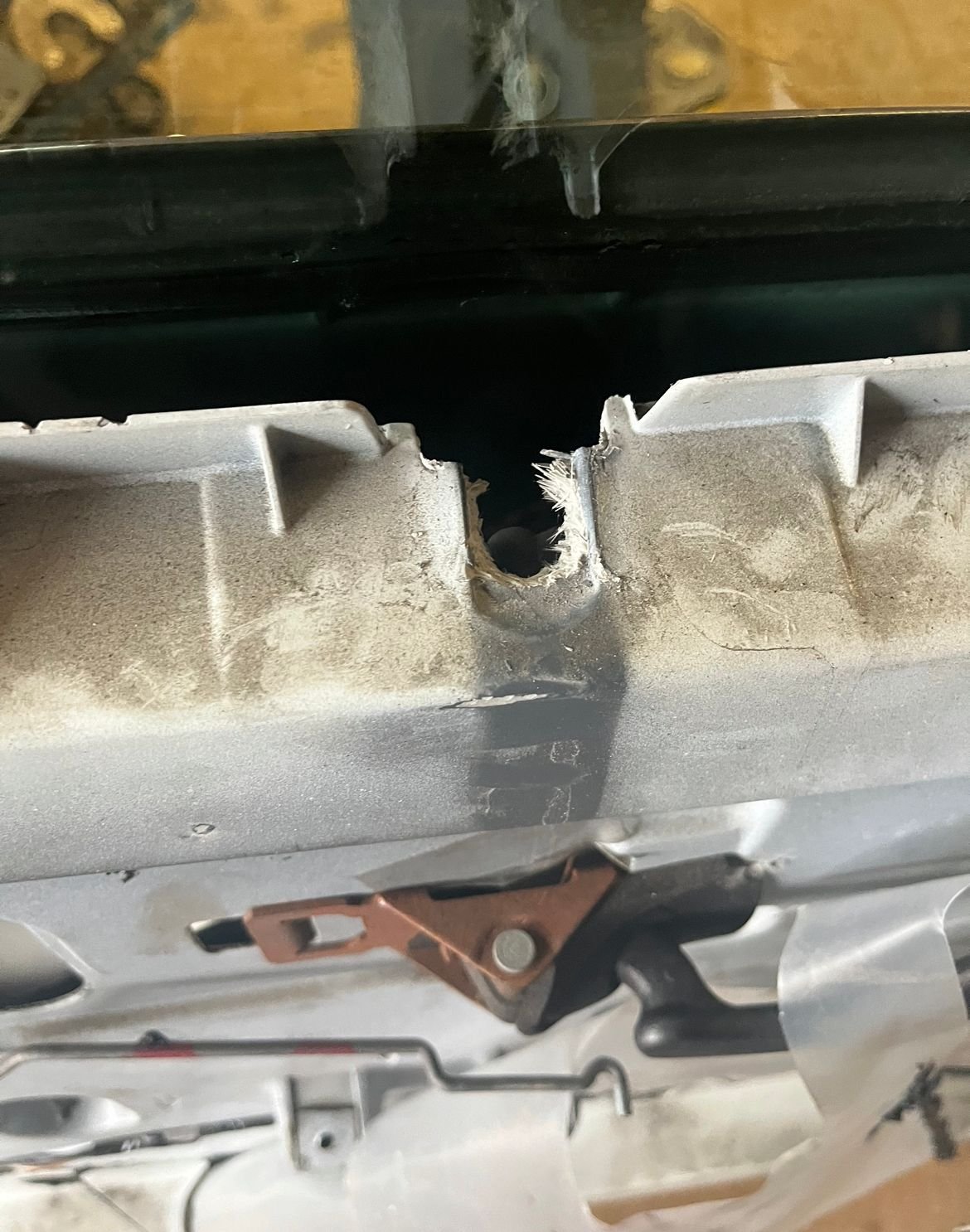

Hi! Glad to be here! Big problem apparently worth my 2001 Camaro: Driver’s side motor/regulator replaced incorrectly- and long story short- the 2 window guides broke off! I’ve had several people look at this- and short of replacing the door- seems to be a head-scratcher..!? I’ve attached picture. Thank you all in advance for any help! (PS: I have searched this forum- and can’t seem to find an answer😔

how good are you with fiberglass, I had a couple window motor mount holes worn bad and glassed in some washers for strength and re drilled the holes. I used some kitty hair and some matting. it has held for 5 years so far. I would look at the other side to use for copying. also to make sure the same thing isn't happening there.
I know nothing about fiberglass. But thanks for the info— that it CAN be done..?? Appreciate it! Marie
