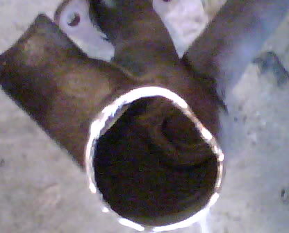

It will fit with some fabrication. Your current cat has the flanges for the exhaust manifolds on one side and the "S" pipe on the othere. There is also a O2 sensor port and a exhaust hanger. It is about the only option besides stock but it is not a bolt in.
Oh yea and the Cat pipe, where you need to cut it, is not really round. It is more like a D shape. I think they did that so it did not hit the floor. You will have to make it round to get it to work.
