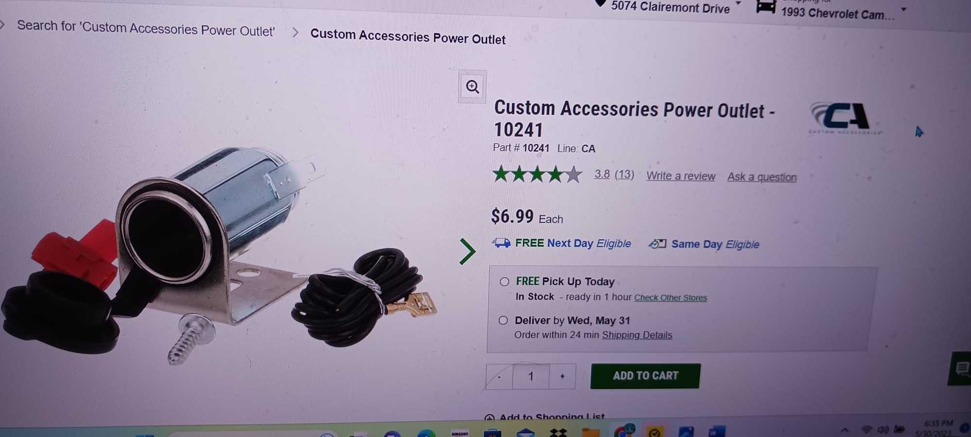

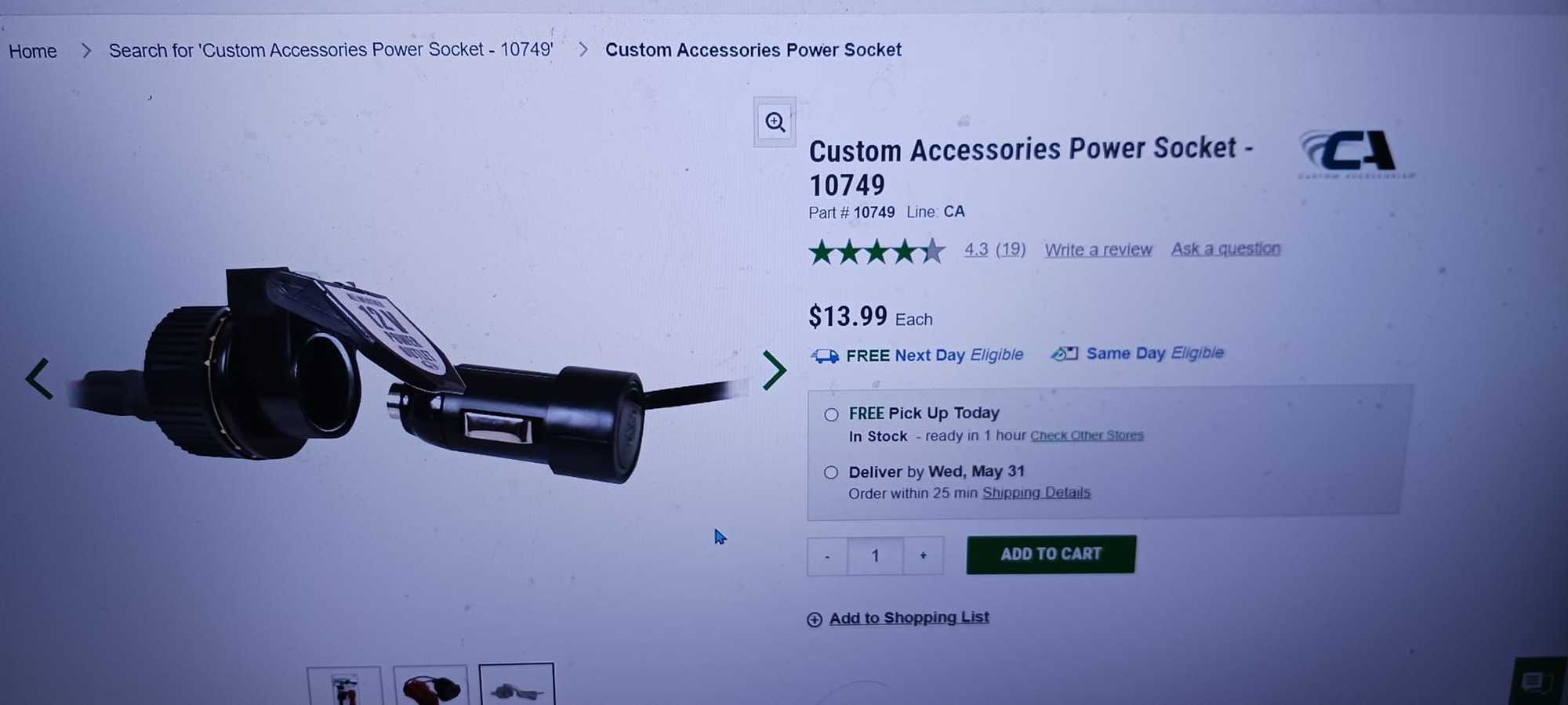

Update: I ordered the following 2 items for my mobile mechanic appointment the day after tomorrow
Rather than having him go inside O'reilly's actual brick & mortar store, where I will be meeting him, after finding the problem
Only to learn that the parts are out of stock and can be ordered,
I anticipated the worse case scenario, that the car outlet (it's not a cigarette power cord, because I don't smoke) is BROKEN or not working as Craby ^ was nice enough to suggest a worse case scenario, SO I WENT AHEAD AND TOOK THE INIITIATIVE AND MADE 2 PURCHASES AS SHOWN....
The neighbor mechanic checked ALL the fuses, including the one fuse that fits into #11 and none of them were burnt or blown
It cost a total of $20 to be delivered by door dash for close to another $25
It's worth it, in this day and age, you need a power source for tire air pumps, for your cellphone, / GPS etc
All the 2 parts Pictured / Photographed FIT a 1993 Camaro v-6 base per O'Reilly's Part Fit System Field
Did I make the right purchase?
Please see pics attached ... and thanks again for any helpful info.
