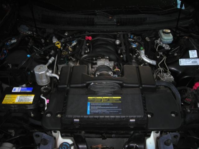

well guys, will try it in the morning when the sun is out. wish me luck, will let you guys know how it goes with a picture.

well heres after the pressure wash.

Looks great, no problems then I take it?

nope, thankfully none at all, just got in from driving it, the car just feels like it runs better knowing its clean inside and out, or maybe its me... I`m satisfied how it came out, but know i cuda do better, just sunday laziness ;D

Well she cleaned up nice!
