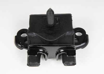

ACDelco's vehicle list says this 22174970 automatic transmission mount works on my 2002 Camaro RS V6 (same unit my 2001 Camaro SS uses) and multiple V6s are listed as compatible:

But my Chevrolet shop says it does not line up, and I instead need this one 10303747 (which I read is oil-filled), what gives? As a tip to others, be sure to PUSH UP on your transmission to see if your mount is still intact -- visual inspection does NOT suffice. Mine visually looked ok, but the rubber was completely useless and broken.

Does the oul filled one cost more? Compare your new part to your old one. If all the bolt holes match up, more than likely they are trying to upsell you the oil filled part.

v6 uses a hydraulic style mount, the v8 mount will not work without getting a v8 same trans as you have brace.
the v6 trans brace has a dip in it and you have to use something for spacers to make it work and drill out the hole so the v8 mount will line up, its one of the oldest v6 mods out there.

You just need an a4 trans brace form a ls1 v8 for your rs, bolts right in.

For those curious, here is what the broken OEM V6 Trans Mount looks like -- the rubber just separated...
