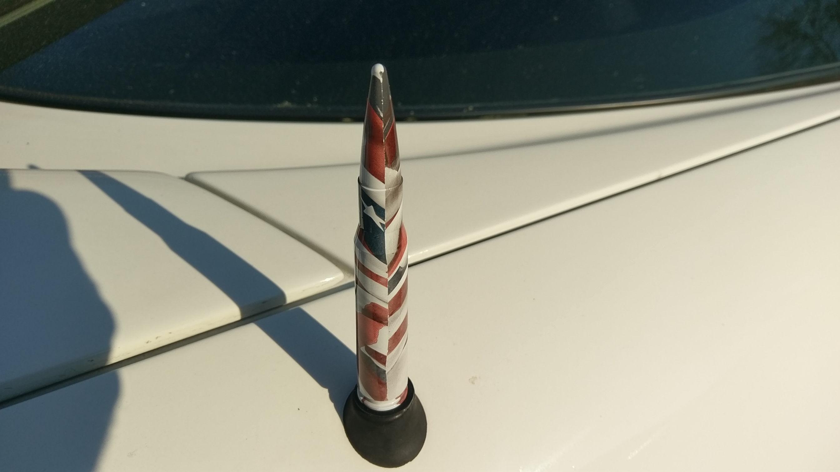

Also got my one tacky addition to the car, courtesy of eBay.
