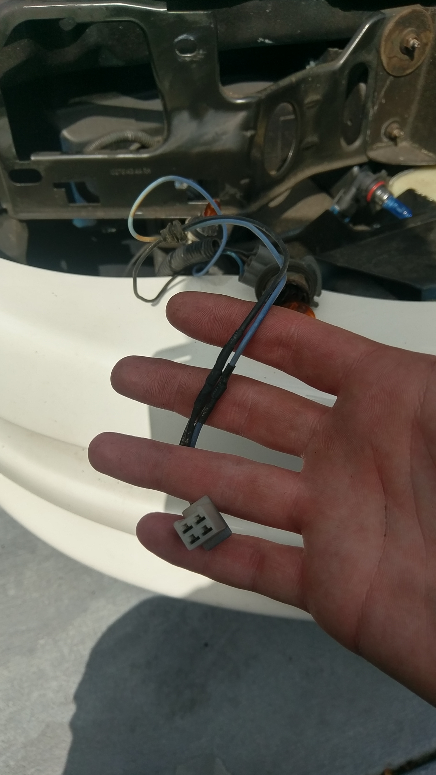

Got my light housings, doing the install, ran across this. Fog lamps are connected, and there's one of these each on both sides, not connected to anything. What are these?
-edit-
Leaving the bound up and visible until I can figure out where they're supposed to go.

dont know an extra wire if your fog lights are working on there own switch , when i did my conversion ,the fogs an head lights just all plugged in the same ,plug an play ,did not have extras on my 95 though wired the extra leds in ,i heard craby say in another thread they sometimes put extra wires in some of the cars from the factory

Looks like I might have factory extra then. I'll test them here tomorrow, see when they're live, voltage, amps, etc. See if I can run something with them.

looks like aftermaket wiring. wonder if someone had some hid or projection lights in it.
