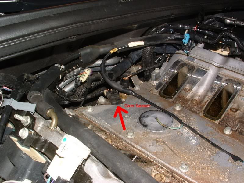

time for ls6 intake?

Probably not LS6, just keep the stock one for now. I still have to buy seats and save for all the parts to do my cam shaft, headers, and exhaust.
