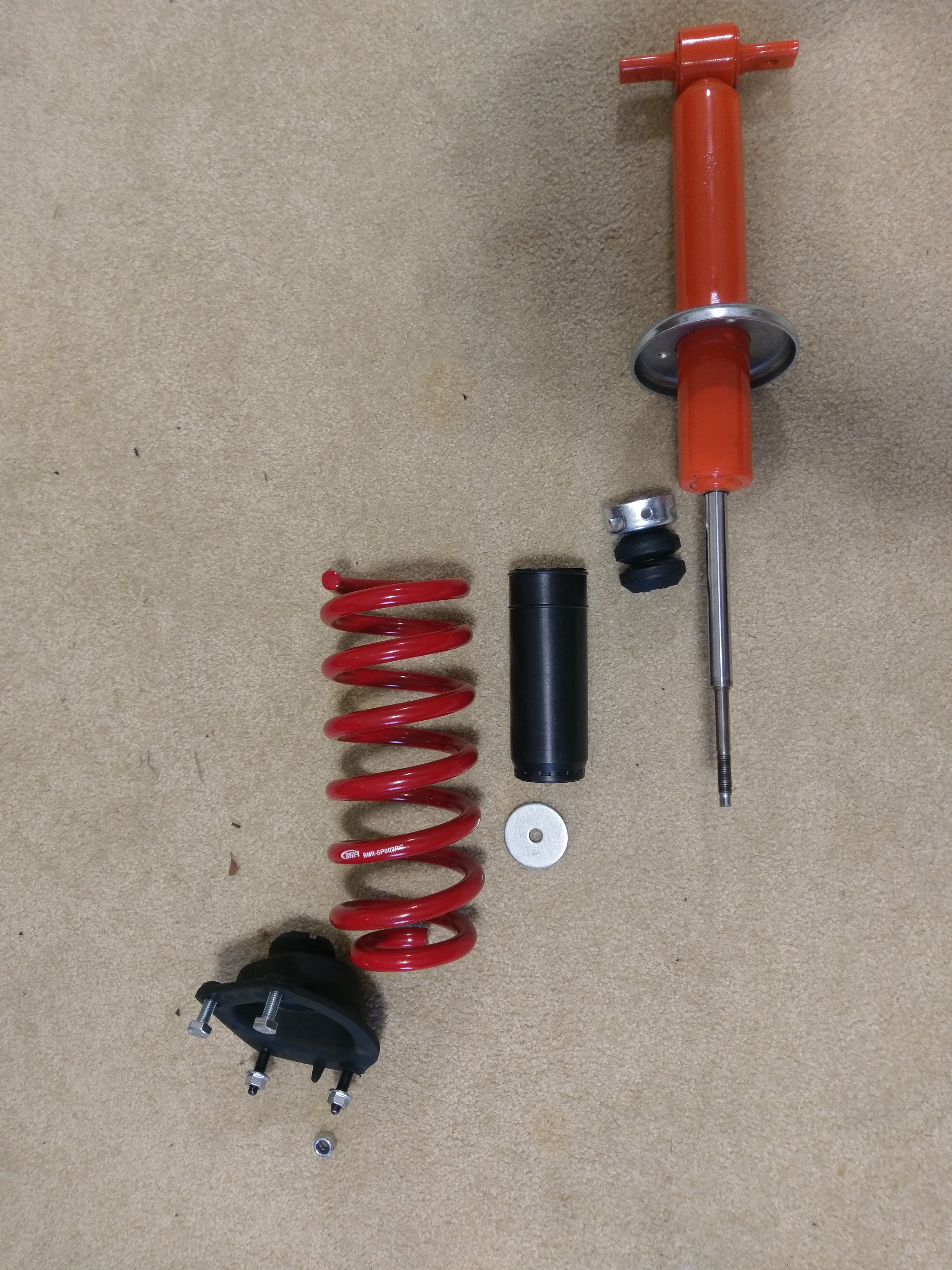

You got the front shocks set up right (yes they ARE shocks, not struts). That extra hardware looks to be for the rear upper mount of the shock (between each side of the body). Except that cup thing with the taps at the very right of the picture. No clue what that is.

That thing with the taps gets 'tapped' (pun) onto the base of the shock up front where the bump stop would hit the body.
That's a laid out picture of how it'll go together up front.

Of course, you'll have an insulator that sits in the 'strut mount', and an isolator that sits in the spring perch on the shock, but mine aren't here yet. All of the rubber parts on this car are order-online only, because all parts shops seem to have them listed as 'rare special order item'.

I got all the rubber stuff from my local parts store. Moog/Monroe make them. I don't remember having that cup thing in the bump stop...but it's been like two years or something. Haha

The cup just acts as another layer of metal for the bump stop to pound against if you're able to actually bottom the car out that bad, so it's another layer of protection for the shock's internal parts.
You just tap it on after you get the spring seat and isolator on. You can hammer it off later if the spring isolator gets rotten or something, but the shocks are usually dead by that time anyway.
