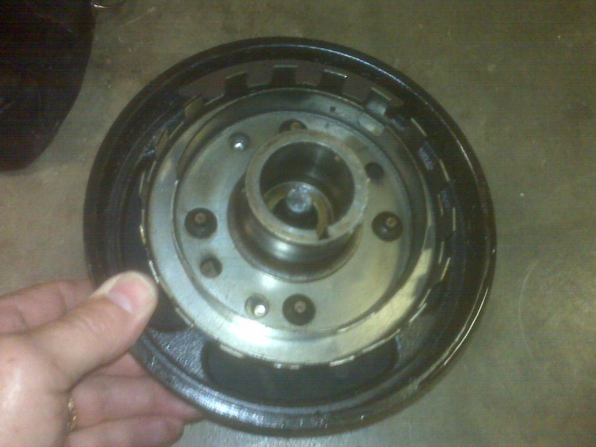

  #30
osduck5's Avatar
Joined: Jan 2009
Posts: 1,646
From: Knoxville, Tn
Here is a pic of the back of the pulley in case you are wondering what it should look like. The front of this pulley looks like the one you posted with the diaghram except the 3 holes are longer. This is the original pulley from a 96 3.8
Attached Thumbnails Update: Still no spark! 96, V6 3.8L.-img00144.jpg   Update: Still no spark! 96, V6 3.8L.-img00145.jpg   Update: Still no spark! 96, V6 3.8L.-img00146.jpg
