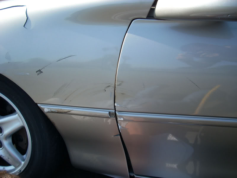

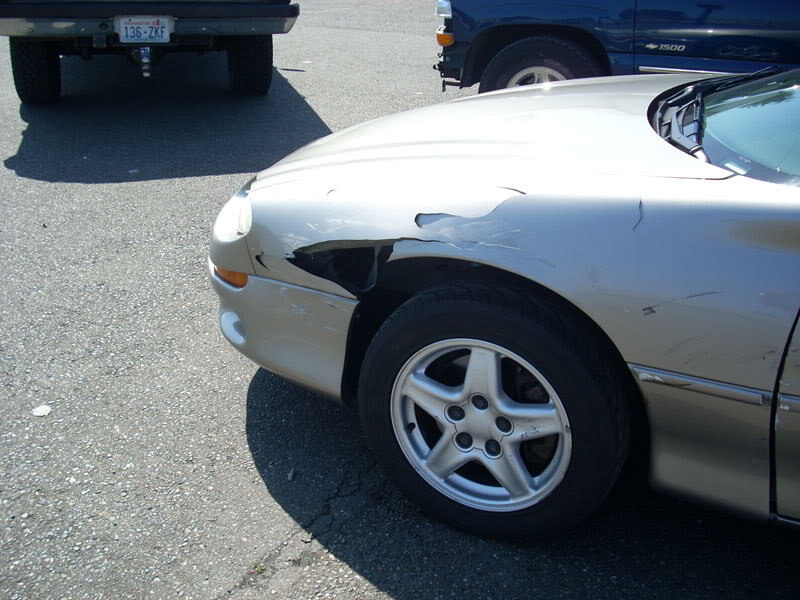

OK here is the wreck pictures and what I have done so far to repair her. The wheel took most of the hit and the control arm was messed up bad. I had the wheel lazer balanced and the runout was less than 1/32" so the wheel was not bent in the hit. I have a new fender and door and I even scored on a passenger side fender that did not have the lower tab broken off like mine does.
Here is the hit I got. The wheel is hitting the inner fenders. This was just a bent spindle. Check out the spindle pics below to see how bent.

Door damage. It actually busted the inner frame too. The hit is right where the reinforcement bar is.

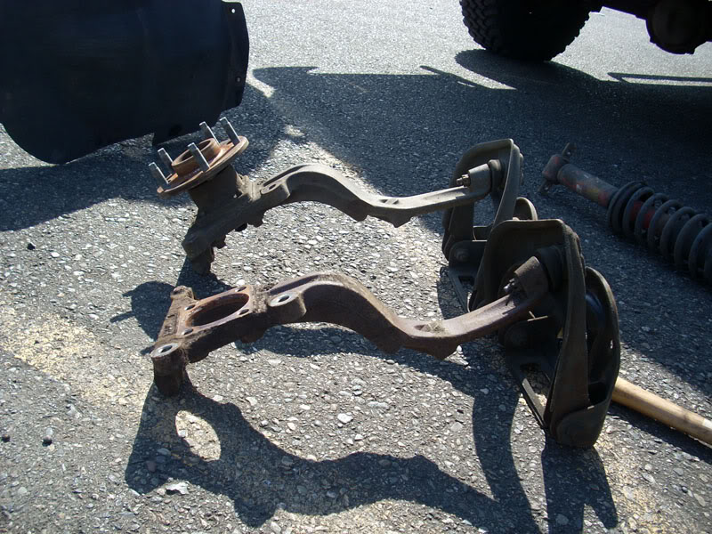

Front Suspension all nice and bent up.

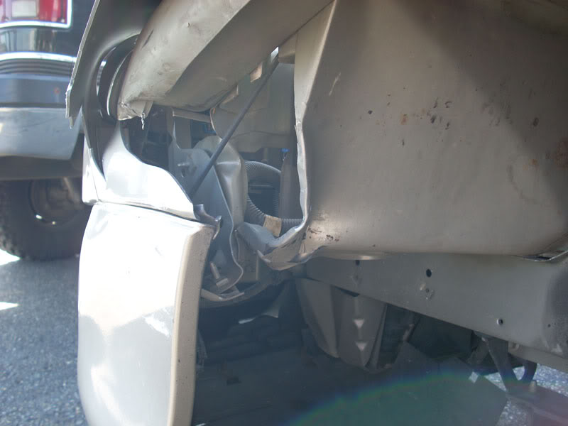

Inner fender behind the front of the fender and bumper. I still need to fix this part but I will do that when I get the bumper cover and fender off.

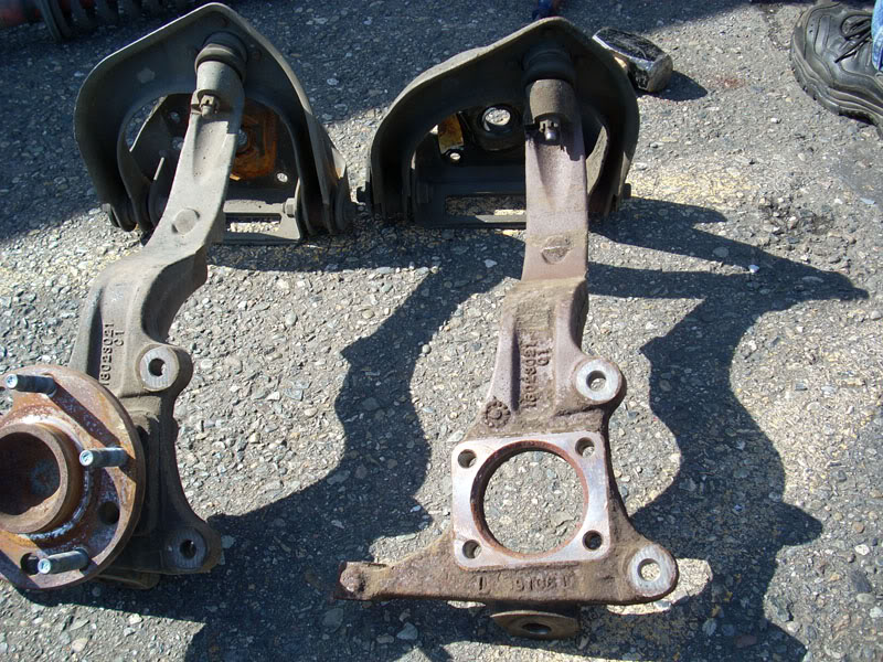

Spindles, My old one is the one without the bearing in it.

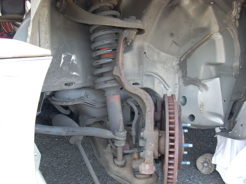

Here is the car back on her wheels with the suspension repaired.
