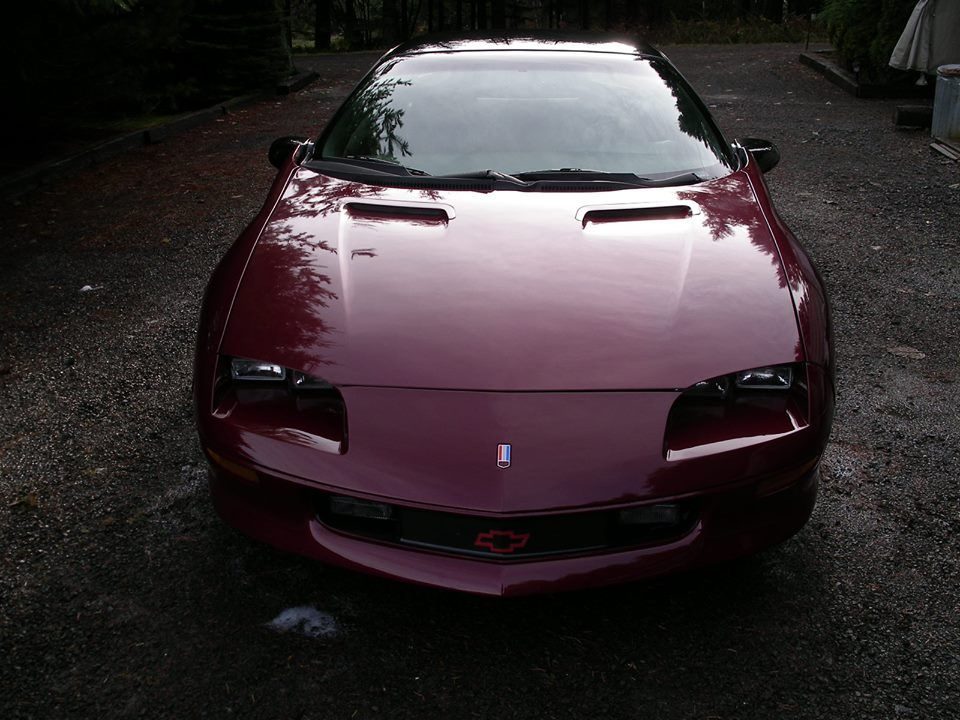

My '93 had 222,000 miles on it when I sold it and still ran like a scalded dog.
Nice color on that one.
