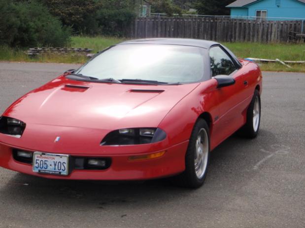

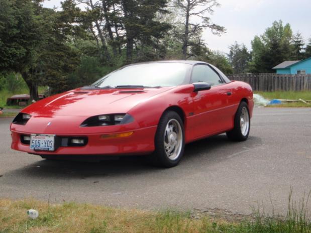

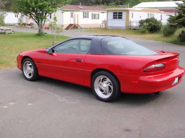

i have koni double adjustable front shocks that have two settings one is stock hight and the other which is what i have it on drops the front about 3/4 in. on the rear i did the spring mod or hose mod. i am using the thickest marine fireproof fuel hose i could find at the marine store. it has 1/4 in sides with 2 ply cord in it. it dropped the rear 1 in. i may go with another layer of a little bigger hose to soften the ride if needed. so far it rides great. found the tires rub just a little with a load in her going over rolling bumps over speed limit. am planning to roll the wheelwell edges soon.

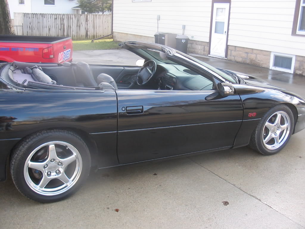

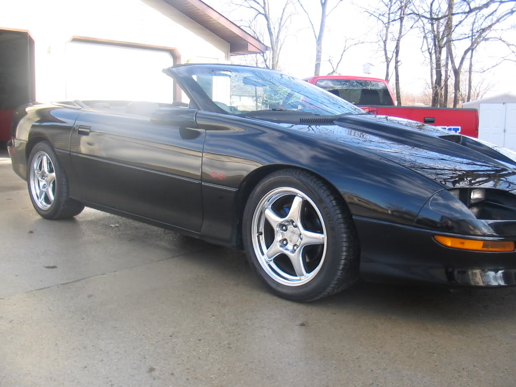

thats more what im looking for, how low is that????

yah wammer what is the drop on the topless lady? convertables set a little lower anyways dont they? is that a 1.2 strano drop?

she's got strano springs which lower it 1.2 inches(but i'd guess more like 1.5-1.75) and i have the kyb adjustables the whole way around. glad you guys like how she sits!
