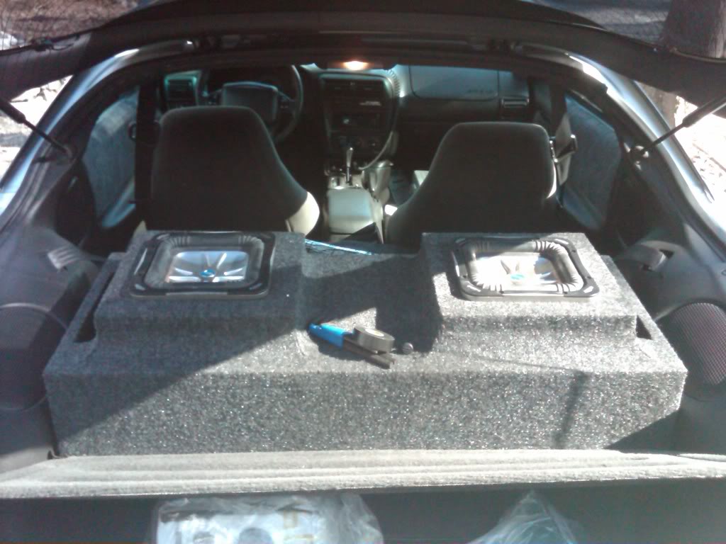

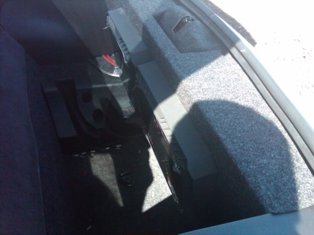

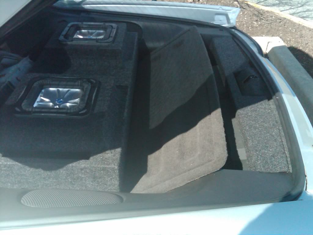

ok here is a run down of my system i have a pioneer dehp5100ub, steering wheel control adapter, two pair of infinity kappa 6.5" comps, one pair of 4" infinity kappa's coax, have two kicker L7 8"subs in a custom built box, a custom amp rack with a power acoustik 1600.4 and a 200.1 mono. here is some pics

That is a nice setup okay I am glad that I didnt get that amp so I am going to look around foor something alot better and I got a quick question how did you get those speakers in trunk sides? Is it just because the later 4th gen version
