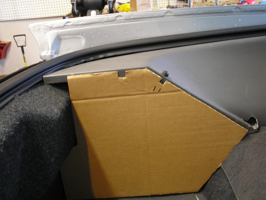

First thing I did was to make a template of the facial. This I did with craft paper so I could easily cut and fold the paper to conform to the cubby hole on the driver side in the back.
Once that was done, I made a cardboard template of the facial of the box. After doing a test fit, I found the where the cut outs needed to be and added them to my template. Make sure you get the cut outs in the right spots.

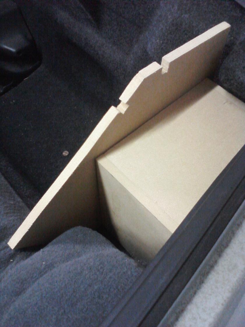

I cut the facial to the cardboard template and build a 6 1/2" deep X 9" X 9" box for it. Make sure the side of the box that is going to be touching the facial is as flush as possible. I found the location to attach the box to the facial by doing a test fit and marking the fit in pencil. Remember to seal the box with caulk to make it air tight. This will improve your sound.

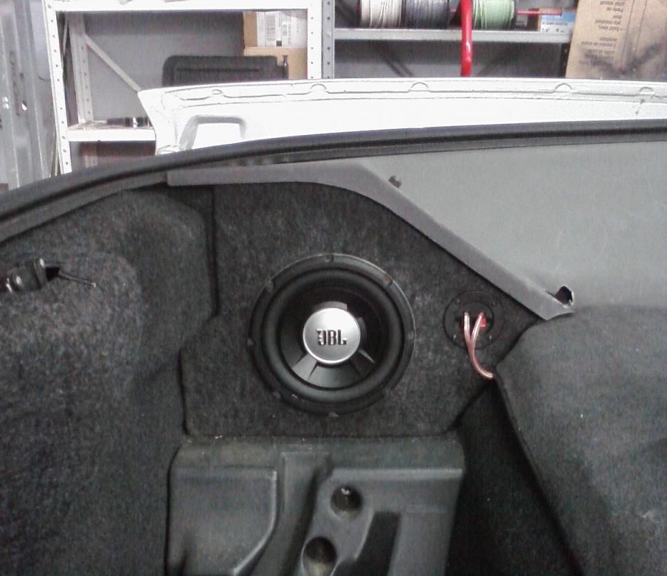

On this facial, I put the speaker connectors on the facial. My friend and I decided that it would look a lot better if the connectors was on the box, rather than the facial. I'm going to make a new facial and move the connectors to the box this coming weekend. It will look a lot cleaner.

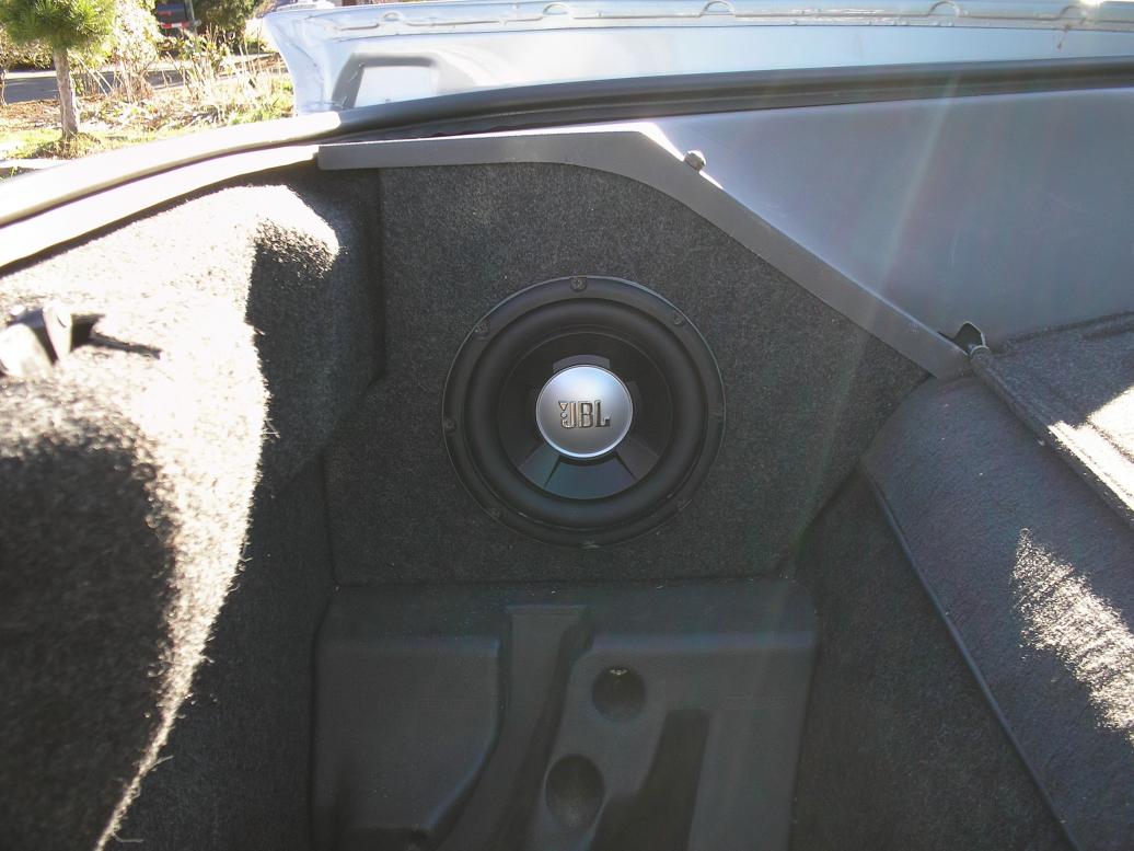

Attachment 6576I don't know but version 1 came out good. I know version 2 is going to be better.
Here is Ver. 2.0
Here is Ver. 2.0
