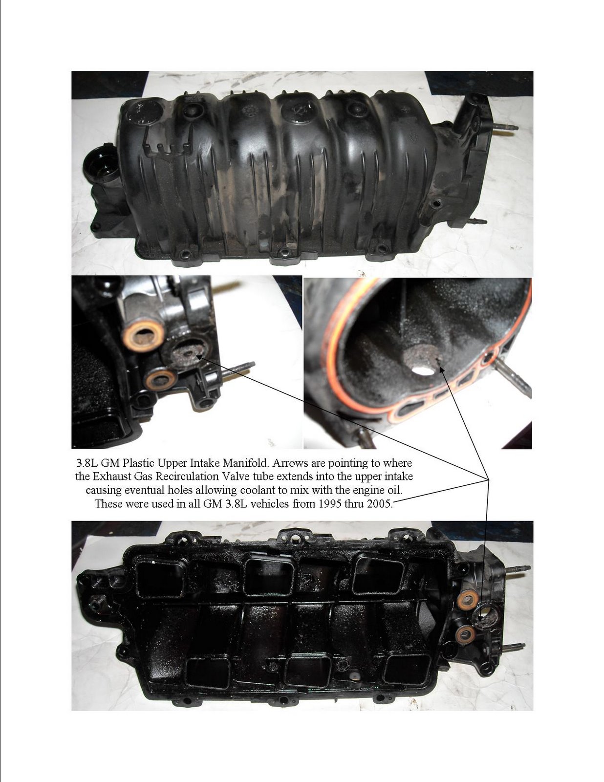

Apparently I have a lower radiator hose leak, have to check when I return to the shop.
The following does not apply to our RWD, but still, wow:
Bernard's Blog: GM 3.8L Plastic Composite Intake Manifold
Originally Posted by Gorn
The FWD have plastic upper intakes and they have issues our case aluminum UIM do not have.
