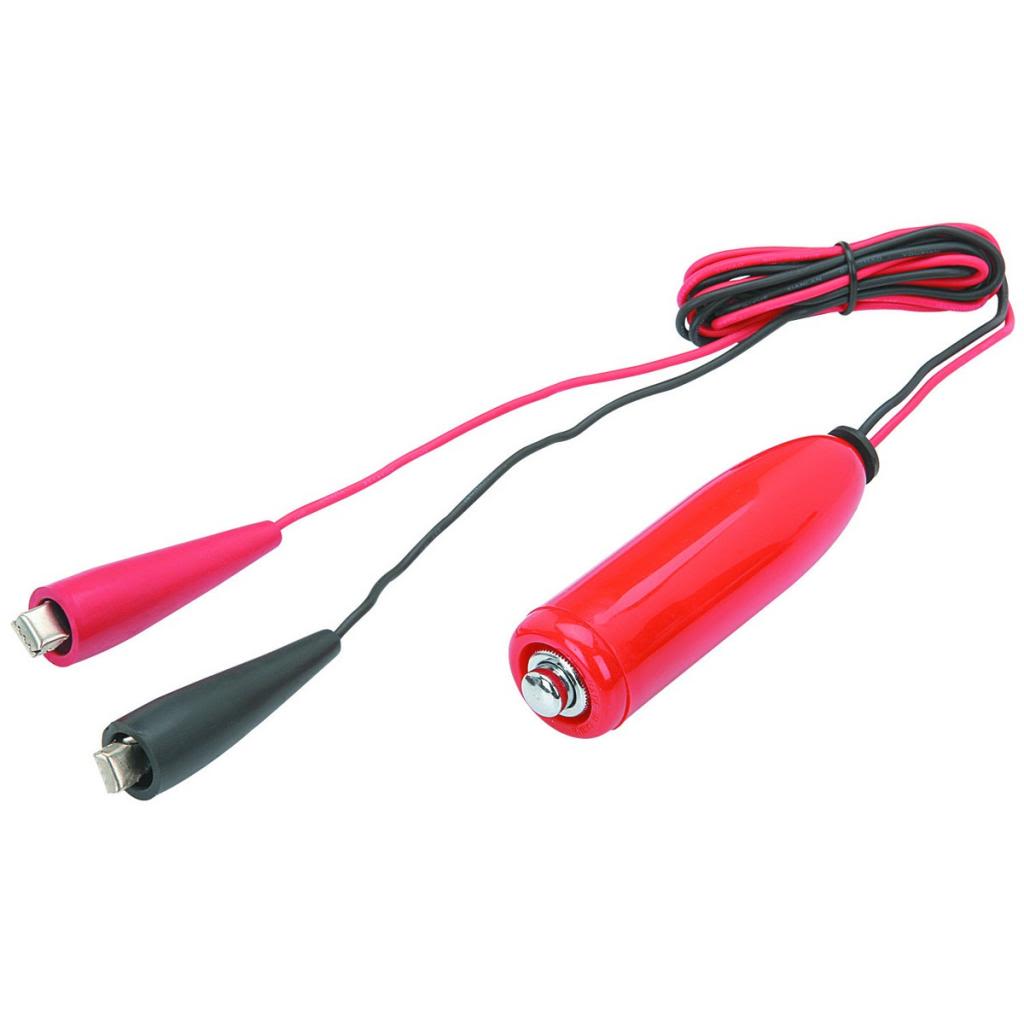

Whoa! BEFORE YOU REMOVE ANYTHING, pick up one of these fairly inexpensive remote starter switches (see pic below). One clip to each terminal on the starter, doesn't matter which to which, and push the button. If the starter cranks the engine over like normal, your starter is fine and dandy, and that means you have an electrical issue.

It takes the place of the screwdriver I mentioned earlier. It's safer for those who've never "terminal jumped" a starter before.

Do you turn the key while doing that? It actually will crank the car?
Old Dec 20, 2013 | 03:28 PM
  #25
It should (will, if the starter is good) crank the engine over with the key off or on. Engine won't start with the key off, and/or having the VATS disabled.
