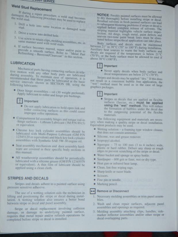

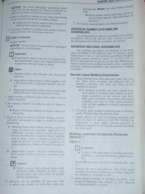

see if u can read this. maybe it will help.
Attached Thumbnails Side Z28 emblems-decal-install.jpg   Side Z28 emblems-decal-install-2.jpg

Thanks craby. I can make out most of it.
