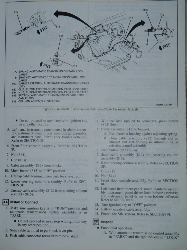

12 is the lock solonoid for a 93 i show part number 10150096

Thanks Craby! So, the way I see it the cable goes into the steering column and somehow is triggered from the key being turned on mechanically to allow the shifter to be moved out of part. AND the brake pedal has a switch that activated the solenoid to also allow the shift lever to be taken out of park. I also assume BOTH of these need to be corking at same time and if either have an issue the shifter cannot be taken out of park, correct? I noticed there was no pic showing specifically what switch or wires on the pedal are related to the brake switch to activate the solenoid. Do you happen to have that info?

gota go fishin, have a look here under electrical and see if its got the brake switch wiring. 4th Gen LT1 F-Body Tech Aids
