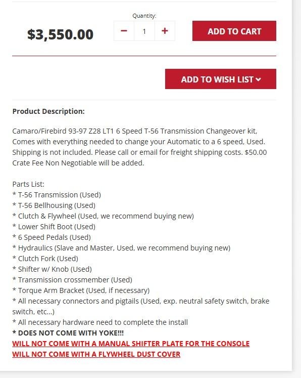

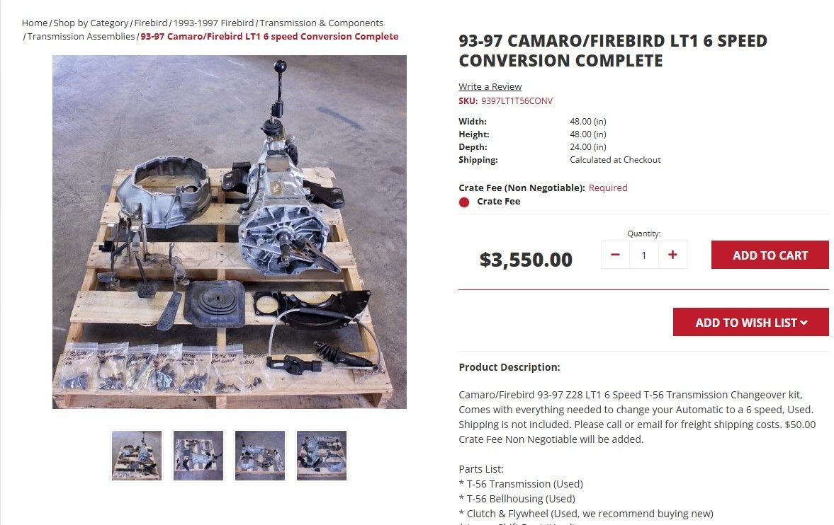

Here is the kit... My wife saw the cost @ $3,500 and scoffed... she did not know this was US Dollars LOL... Plus freight to NZ, Plus 15% GST.....
