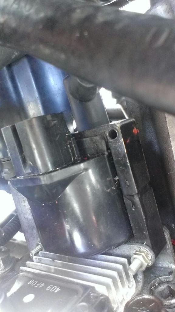

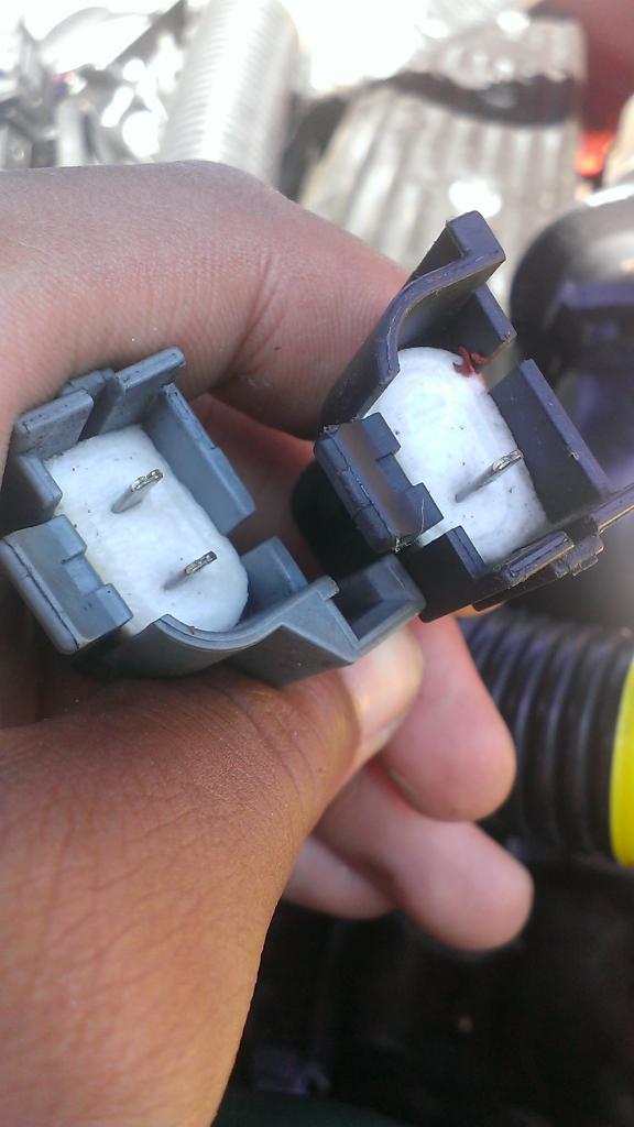

kinda crazy i bought the battery only 1 month ago... also i noticed that there is a metal tooth missing in this? would that cause starting problems? its connecting to the ignition coil. i went ahead and took off the ignition coil and icm going to test the icm at advance auto today. Name:  IMAG0288_zpsqsr0x3ud.jpg

charge your battery. when voltage gets to low the igntion will not work correctly. have the alternator tested, have you tested the fuel pressure with a gauge?

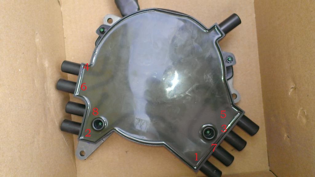

okay so i charged my battery and now it made a loud pop out of the exhaust when i tried to start it? do u think i mismatched the plug wires on the opti? can somone give me a diagram so i can double check

found out i mismatched some wires so im just gunna replace my wires
Was the battery bad?
And here you go. Modified your pic for you.
Drivers side wires front to back: 1, 3, 5, 7
Passenger side head F to B: 2, 4, 6, 8
