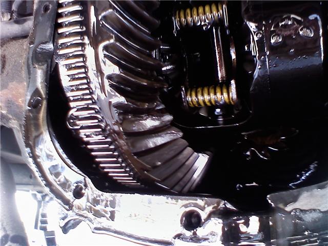

btw heres a pic of the ring and the 3 broken teeth and the chip on the 4th one...

we have the same posi too (yellow springs). there are 2 types in GM's cant remember what the toher looked like, but when i replaced fluids last year i saw the yellow springs in mine.

i have to say that that is the worste smelling fluid in the whole entire car...i hate the smell of diffi fluid. lol
