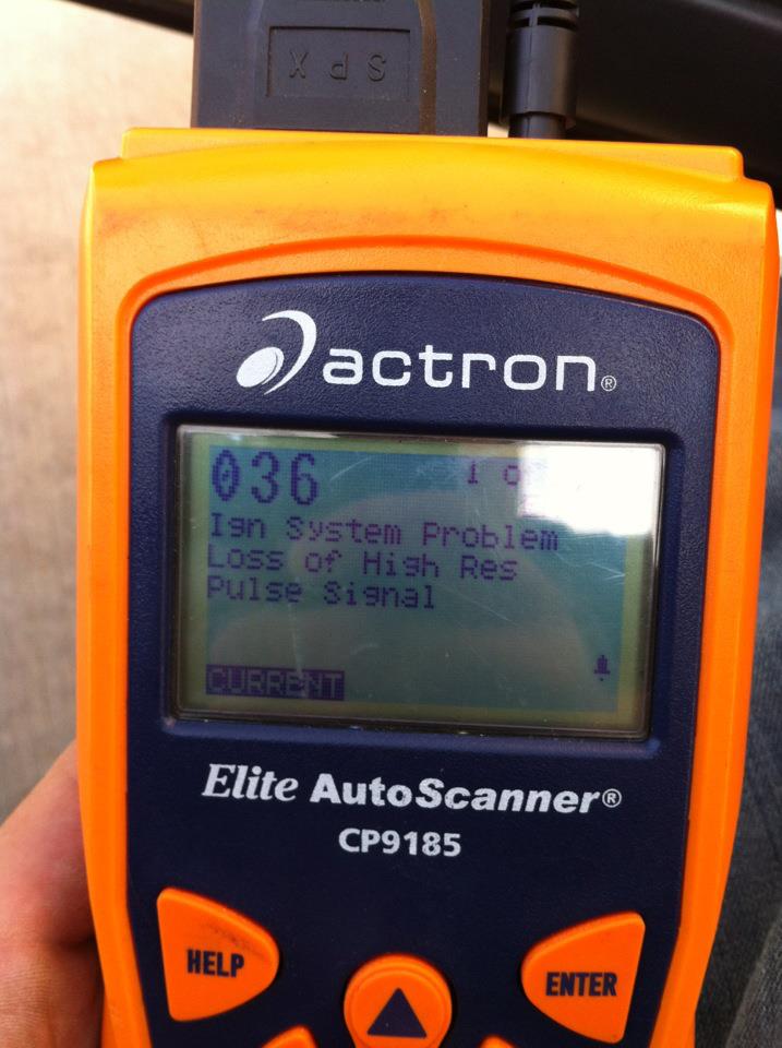

My actron CP9185 with the ALDL adapter reads the OBD-I codes on my '94 Z pretty well. It's going to cost you over $250 new, but they go for MUCH cheaper on eBay.
It just so happens that my Z has the abs inop light on as well. I'll try to remember to scan it with the CP9185 tomorrow evening and report back whether or not it gives any useful info.
Here's a picture I took when trying to diagnose a SES light, turned out the upper connector on my opti was messed up:
