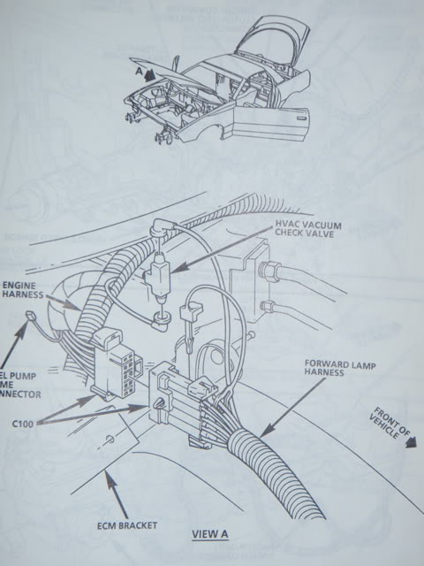

thats accessory, may be for the heater controls. ill have to look.

thats what my boss was saying but i cant see anything there and to be honest i dont remember unhooking it it may have popped off when i dropped the engine a little could that make it run like crap

yep thats what its for. should be a vacuum hose coming out of a wiring harness, has a L end on it.

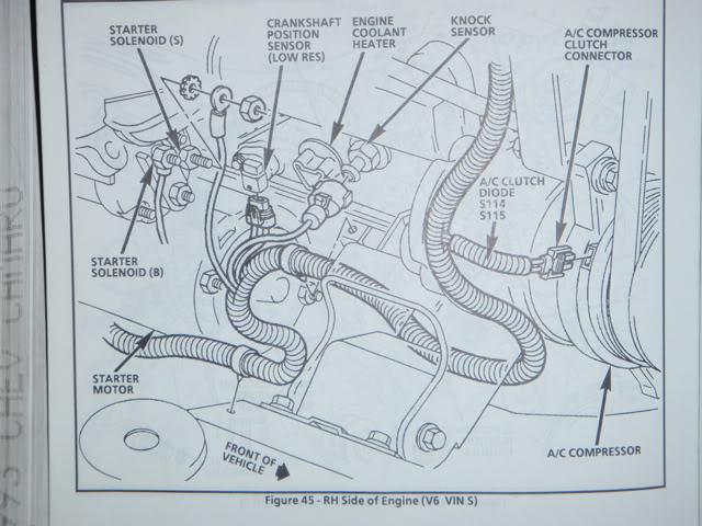

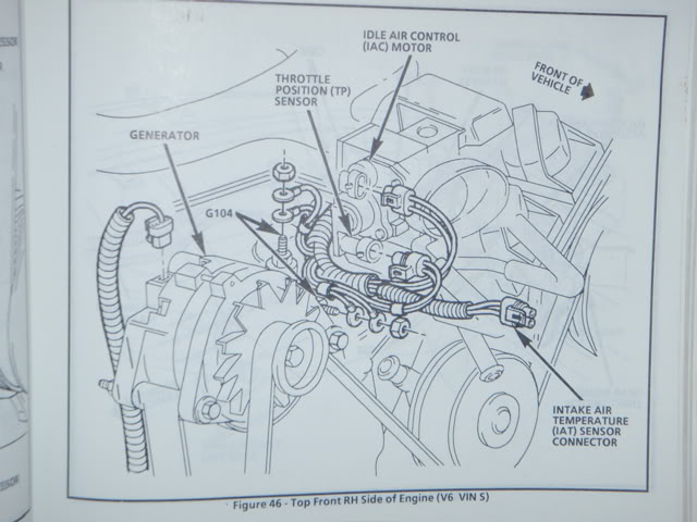

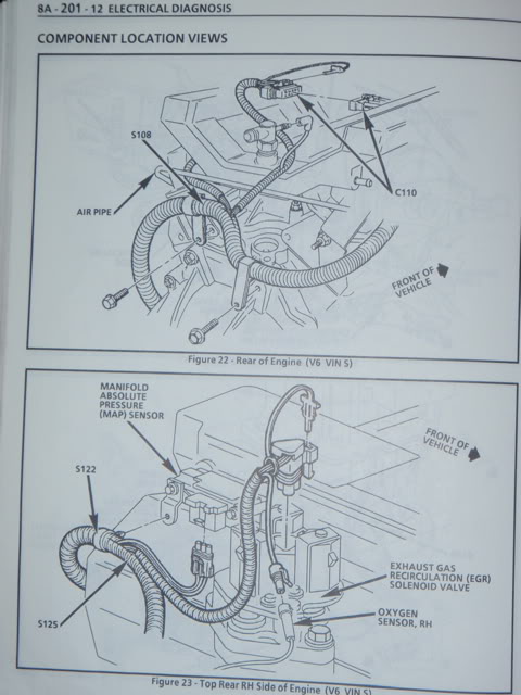

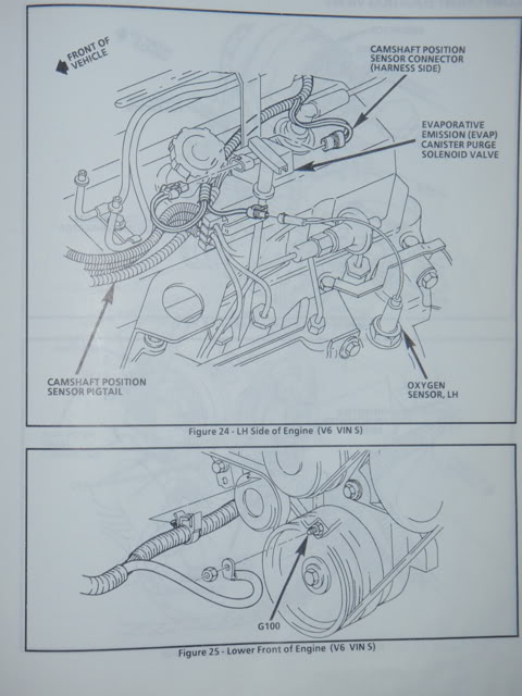

Old Oct 20, 2010 | 11:39 PM
  #26
Posts: 22,040
Size:  62.3 KBName:  PA200002.jpg
