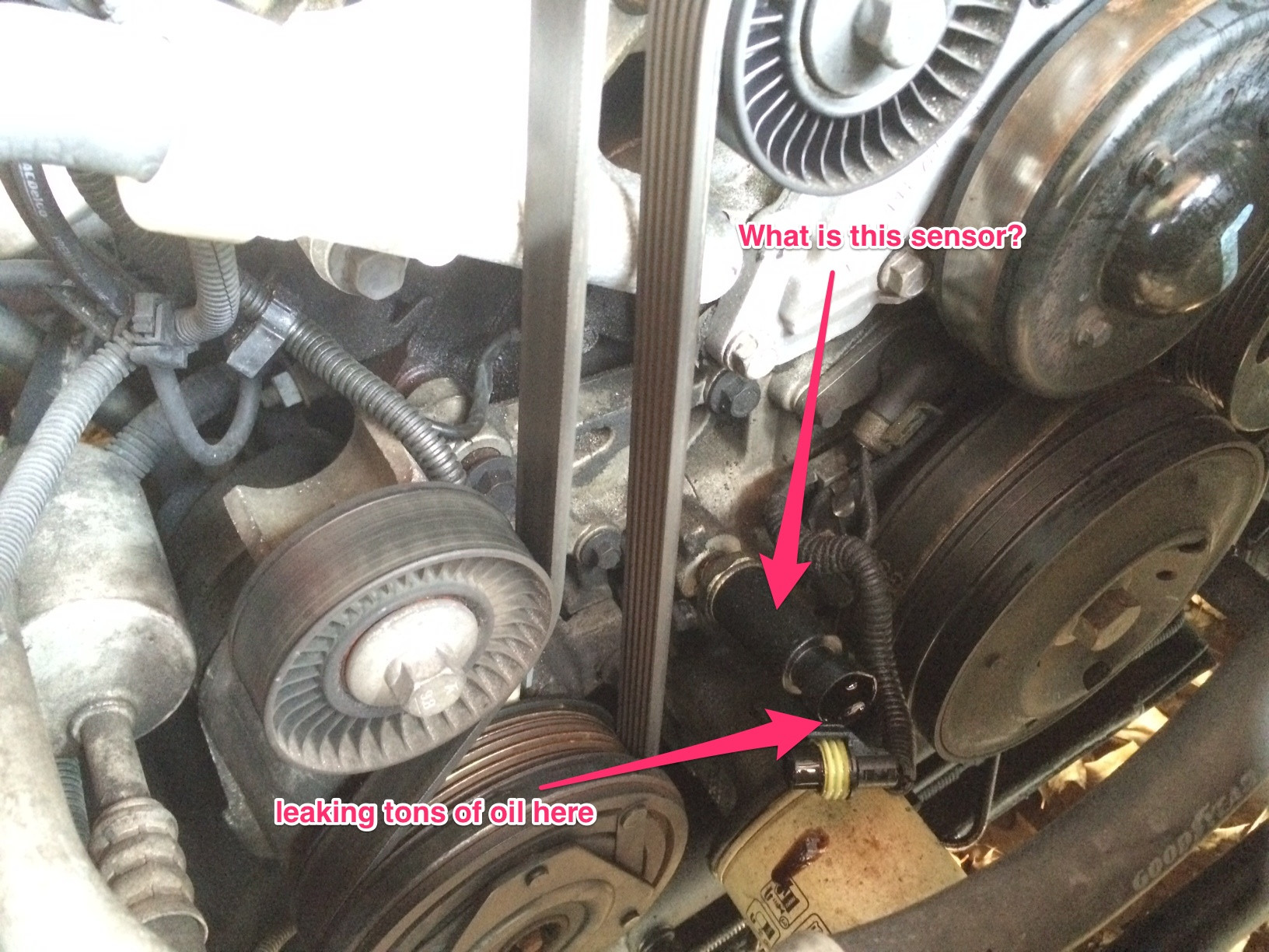

I have been trying to find out where a leak has been on my wife's 97 Camero RS and today while looking it over I seen that it is coming from the front of the engine out of what appears to be a sensor.
I am not familiar with Camero's as I normally work on VWs but I can handle fixing this as it seems pretty easy. Any thoughts on this one guys. Any help would be appreciated. Thanks

Oil pressure switch, for the oil pressure gauge. Yep, it's bad when you get oil from out of there, and can also be the cause of a low reading gauge.
