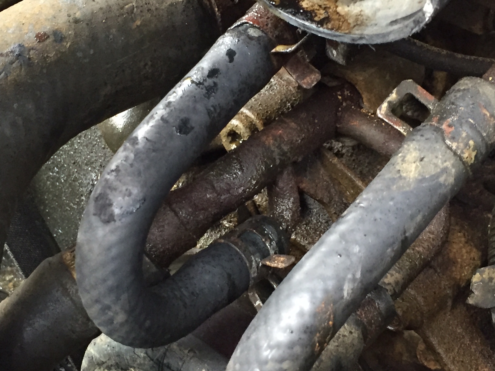

Does anyone know the name of this tube? I am looking at the metal one with 3 hoses connected to it. It is on a 1994 V6 right under the thermostat. I need to replace it as mine is shooting out coolant. I took the picture to 2 auto part stores with no luck.

Service manual names it "PIPE, HEATER INLET". You will also need "NIPPLE, HEATER INLET" which connects the PIPE to the intake.
