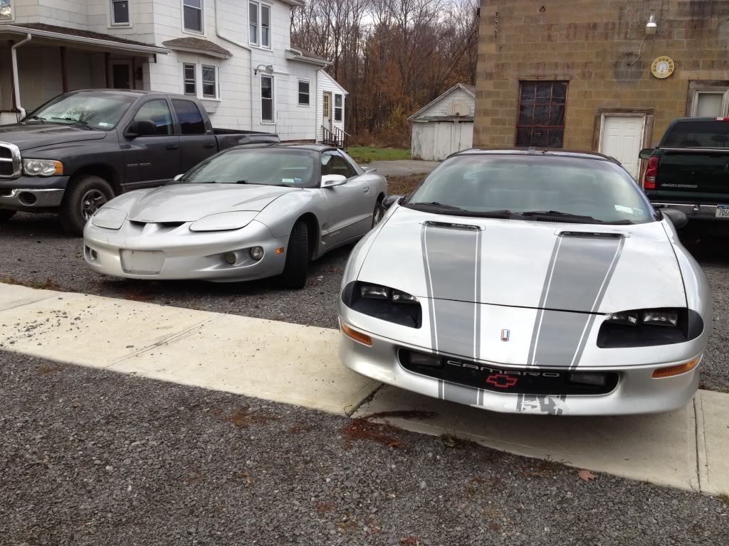

I am saving money for spring to put into it.
I should look for a 12bolt instead of just swapping in 373s?
I did see a set of 373s in the forsake listings on the site for 150$
But I think I am going to get the ECM tune/dyno as priority
Then tires (the tires on it are getting old)
Suspension and breaks will come once I put it on the road and see what I am working with.
