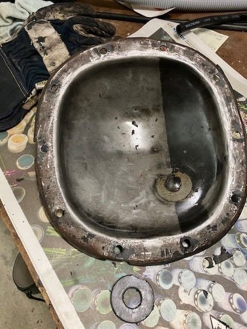

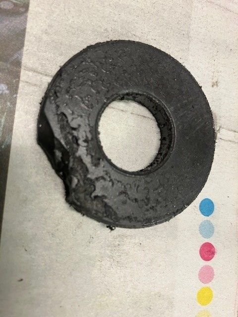

Drained my diff this weekend and found the inside cover magnet had come loose, and its seems like the diff has been taking a nibble of it too.
Question is if to try and glue it back on, or just leave it out, or maybe buy a new cover with a magnet?

should stick to the metal on its own, may want to pick up new magnet and see if it sticks. idea is to remove any tiny pieces of metal caused by normal wear.

I get the idea but it seems counterproductive if it comes loose as has happened here, was thinking on replacing the level plug instead with an magnetic one, if available...
