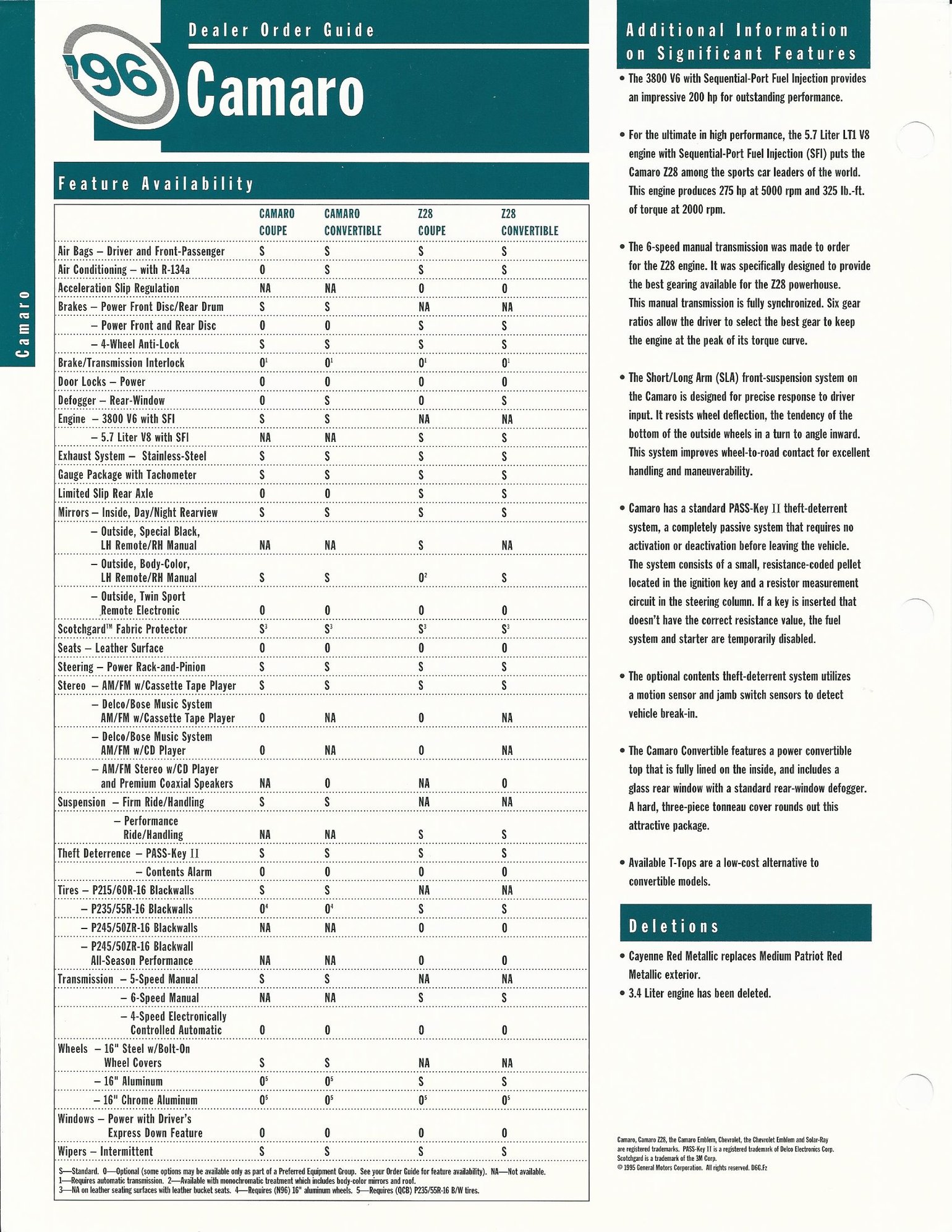

Found the below online that indicates the remote keyless entry likely didn’t include any theft alarm system until 97, which if so is good news to me as I don’t have to worry about any alarm going off, and I assume the so called Immobilizer likely had been introduced a 1-2 years later? was unable to find that info on the net ....
In a way the start key needing to have the correct resistance is a kind of Immobilizer light I suppose...
So, if I sum up my case; with the theft alarm and hopefully also Immobilizer excluded, its only about how to unlock the car, manually with key, or getting an aftermarket key fob and program it according to the given instructions in this thread, so thanks to guys I think I'm all set
Is there possibly any owners manual PDF somewhere on this site?
Edited: when running the VIN decoder it shows that I might have the alarm system after all, it says "PASS-Key II theft deterrent system", unless this refer to the start key with resistor? also recall I have a little red led flashing on the dash....

Old Oct 2, 2024 | 09:45 AM
peterpar's Avatar
Joined: Jun 2016
Posts: 611
Yes, This site has a post listed to where you can download them at the bottom of the Forum page. Here's a link to the site. Camaro Owner Manuals in PDF format on Chevy Camaro (chevy-camaro.com)

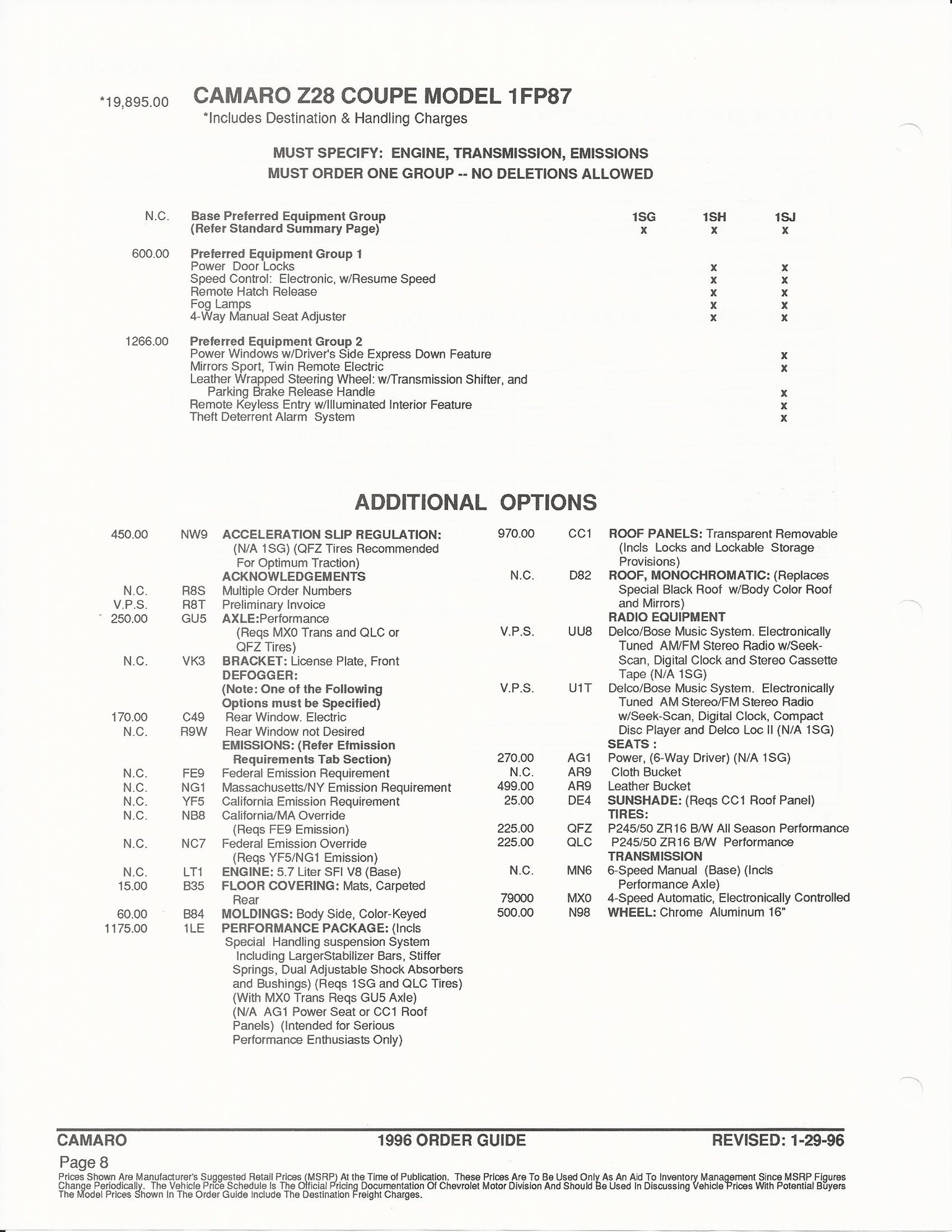

Old Oct 2, 2024 | 10:04 AM
peterpar's Avatar
Joined: Jun 2016
Posts: 611
This is from the 1996 Chevrolet Order Guide that list what was standard and optional equipment. Note the power door locks were part of both the 1SH and 1SJ options ( Preferred Equipment Groups 1 and 2). The theft-deterrent option was available only with the 1SJ option (Preferred Equipment Group 2).

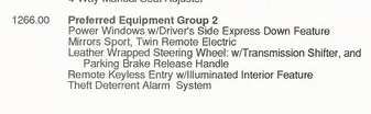

Old Oct 2, 2024 | 11:42 AM
peterpar's Avatar
Joined: Jun 2016
Posts: 611
May be this will explain the theft deterrent package. This also from the 1996 Dealer Order Guide.

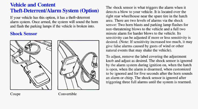

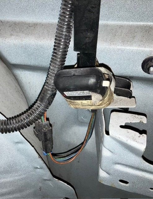

Robroy Z28's Avatar
Joined: Sep 2024
Posts: 140
From: South Sweden near Copenhagen
Again, brilliant help and the owner’s manual will come to good use
I’m pretty sure I have the 1SJ package as I recognize the stuff listed there (first screen dump), and when checking in the owners manual about Theft Deterrent Alarm system (second screen dump), it mentions if equipped with such there is a shock sensor over the right rear wheelhouse, and I think I found it in my car, see the below picture
