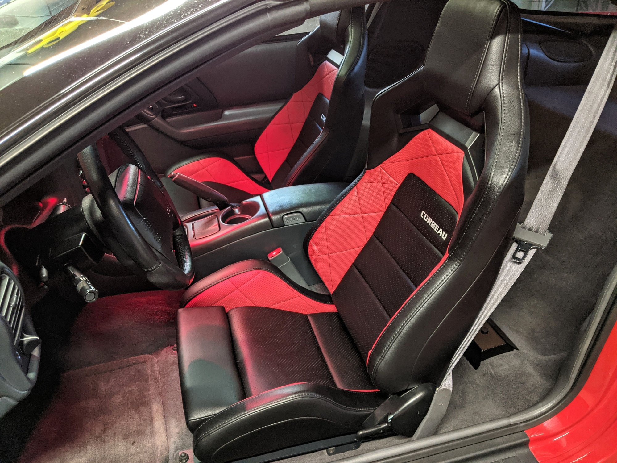

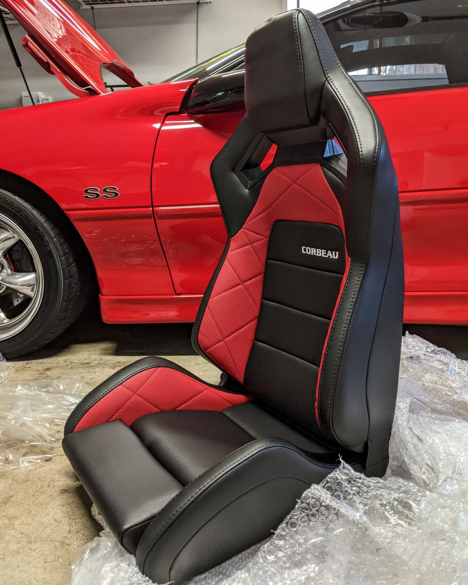

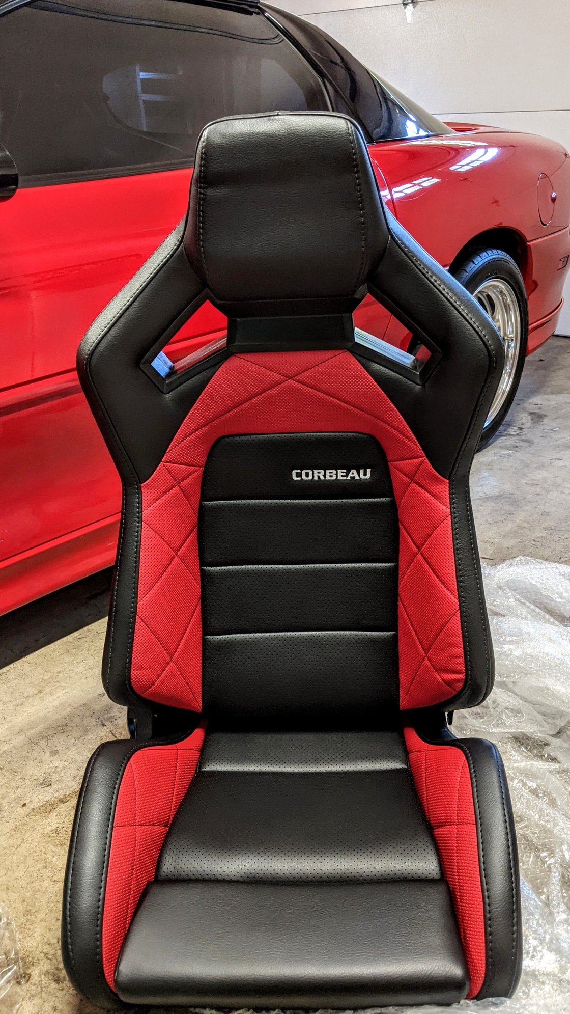

Purchased the black/red Sportline RRX seats direct from Corbeau. Also picked up a pair of Corbeau brackets w/ sliders to simplify the installation process (yes, Corbeau makes specific passenger/driver brackets for our cars).
Fitment was perfect for both the brackets and the seats. No drilling required - 100% plug and play. The seats come with the bolts for attaching the sliders and the sliders come pre-attached to the bracket. Shipping was fast.

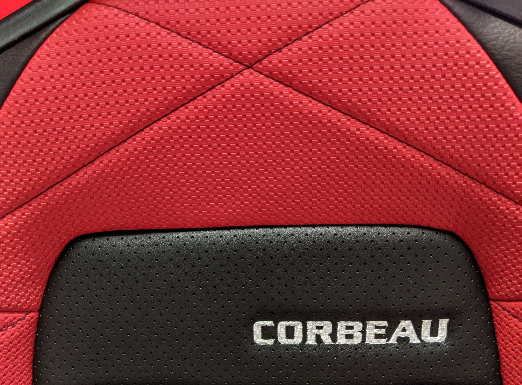

The seats are high quality. Stitching is spot on, color is great, material is soft yet supportive. The bolstering is really nice, especially at the thigh/hips. I'm 6' 1" and I wish the side bolstering was a little tighter to my body, but I only weight 165lbs so that could be why.

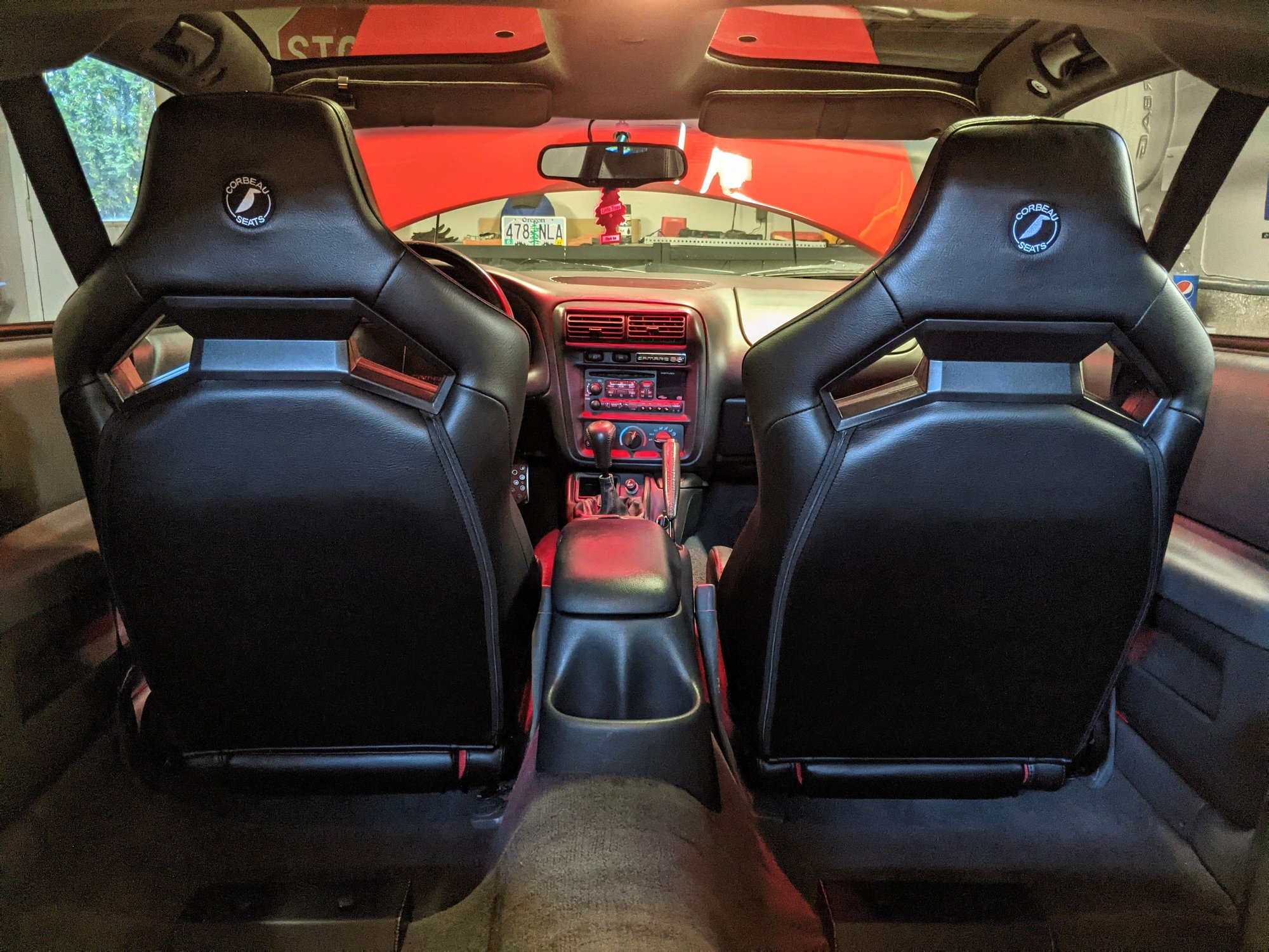

Seating height is the same as stock with the Corbeau brackets and sliders. I may bolt the driver seat directly to the bracket to give me some more helmet clearance. If you don't track/AutoX your car, this won't be an issue. However, I only have a 1/4" between my helmet and the t-top and I don't want to crack the glass going over bumps on the track.
Anyway, here are some pics! If anyone has questions feel free to ask. I also deleted my rear seats and used Hawks Motorsports delete panels.
