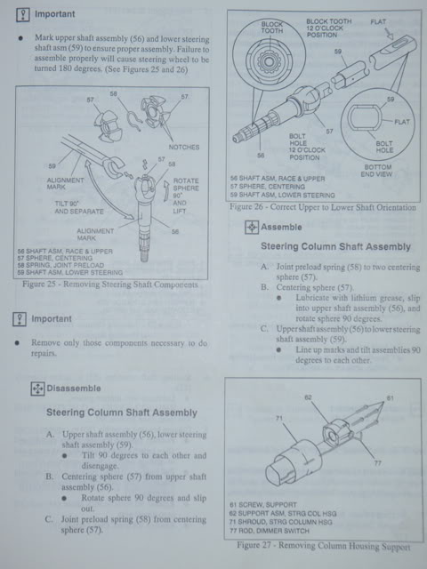

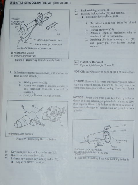

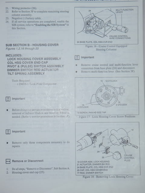

Posts: 22,027

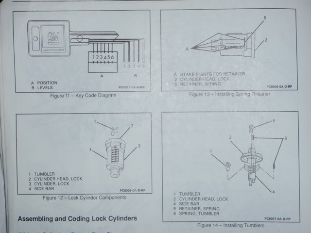

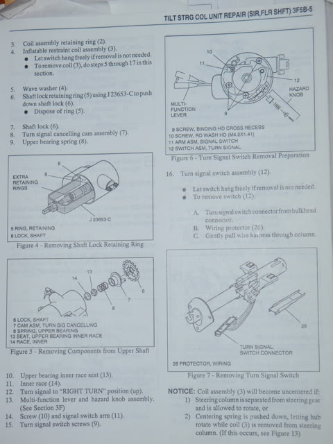

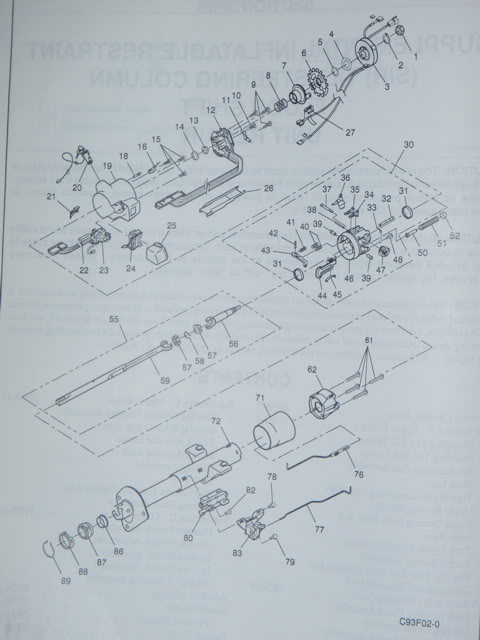

what year? this is from my 93 book.

save the money on the locksmith... what you need to do is put a new lock cylinder in the column. It sounds complex but not really, Follow the instructions that Craby posted from his books.
Go to your local autopart store and buy a new lock cylinder. This will come with a dummy key. You take the key that is in your VATs system, along with the dummy key to a lock smith and have them cut you a new key with the old chip and the dummy key's pattern. Once this is installed in the column you will be able to unlock your wheel and start the car like it was ment to be started.
