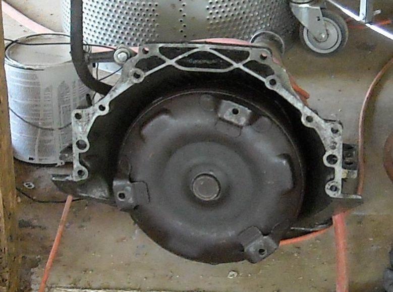

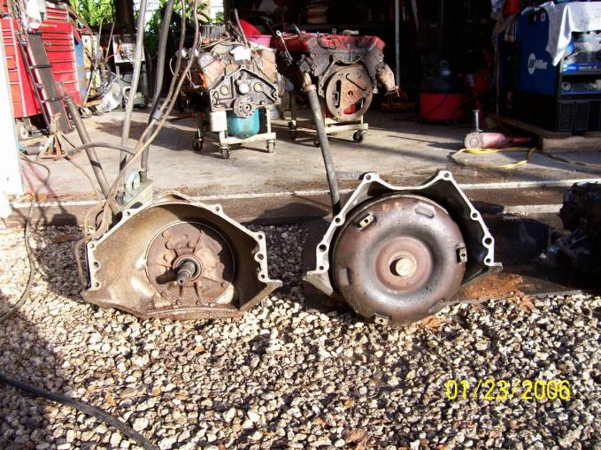

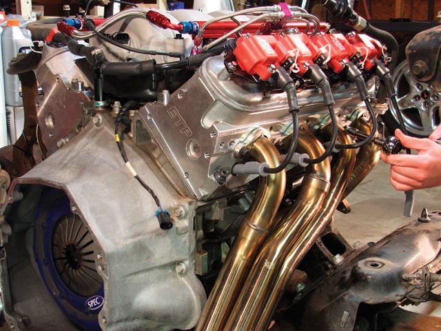

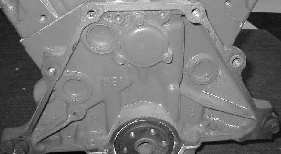

Here are some of the different bellhousings GM has used. THe first shows the Chevy and BOPC housing (BOPC has the dip at the top chevy has the point) The second is a universal pattern usually only found on PowerGlide's and some early TH350s. The 3rd one is the GM 60º pattern found on alot of smaller GM engines and the last one shows the bellhousing installed on an LS1 engine. Also want to note that the Dodge Dakota 2.5L 5sp 95-00 housings will fit the GM 60º engines, and some Toyota Transmissions.

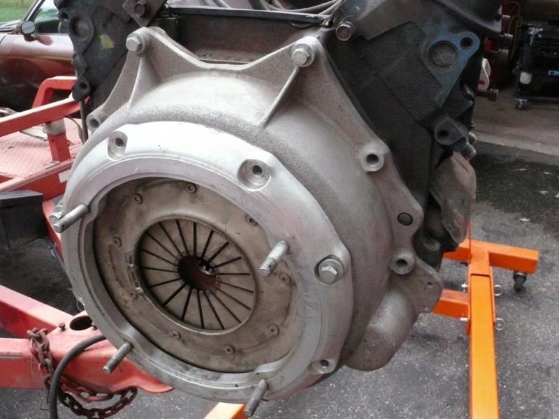

Here is a picture of a 231 with the BOPC bell. This one also has a distrubutor in the front of the engine behind the water pump.
