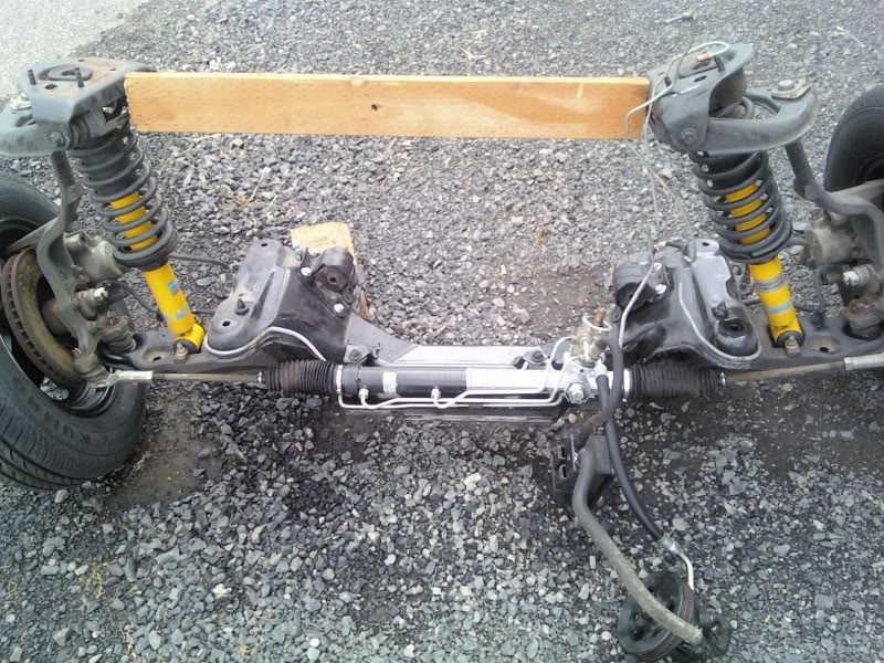

Next we talk 4th gen Camaro. With the 1st, 2nd and 3rd Gen Camaro the motors swaped around easy. GM made the decision back in the 60's to build standards into the engine compartments. The 4th gen Camaro did not follow that idea. Just about everything from the radiator to the rear axle is different from the V6 to the V8. Starting with the K frame
Here is a Pic. You will need one of these from a V-8 and thats just for starters.
