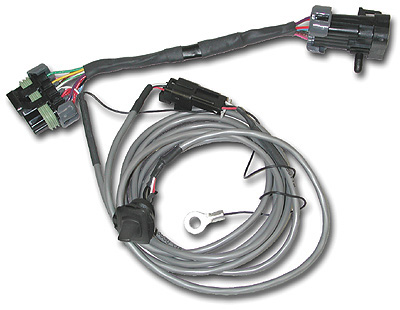

Here's a kit:
1993-2002 Camaro/Firebird V6/V8 Fan-Control Switch - slponline.com
Instructions:
http://www.slponline.com/instructions/63011.pdf
And another option:
http://www.casperselectronics.com/st...oducts_id=1212
