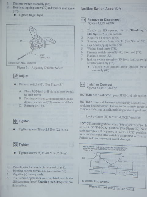

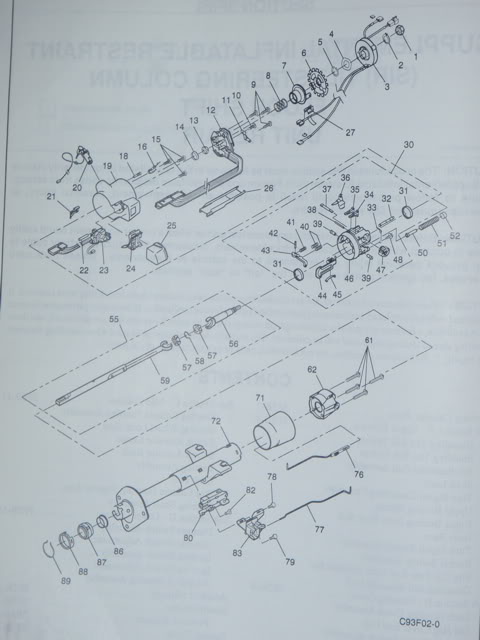

Old Jan 8, 2011 | 08:03 AM
Posts: 22,034
dont know if the latter 4th gens are the same but fyi
